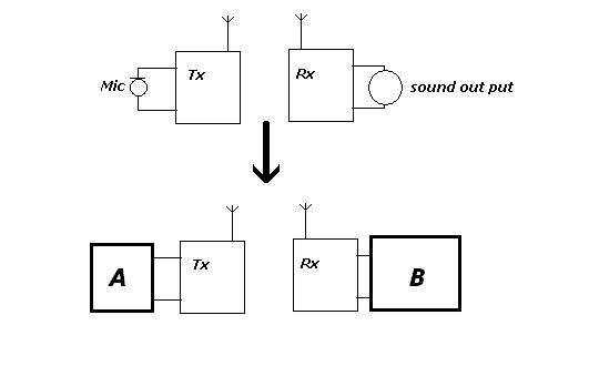

you all sure know about the ready made RF remote control modules like TX431 and the RX431 etc etc.. well i couldn't found any in my country, and it is very expensive for me....
so i bouhgt the cheapest wireless mic i've found, actually ~5$, along with its receiver.. and i figured out that i could turn it into a multi channel RC...
i thought about using 556 tone decoder, which i never ever used before..
I also thought about the pic 16F84A, which i did use a lot...
or maybe a simple mux demux Process....
any hints?? or is that possible anyway?
nb: if i can send a clear signal from a pic to a pic using that mic, my problem is solved, (the multi channel part is really not a problem..)
thx

ok , thx, but i was thinking, isn't there a way to send a frequency very simply though A and then pick it up through B ? i mean isn't there a respective change in output B for any change in voltage at input A ??
thx again kinjalgp, and i am sure what you are proposing is the most professional solution but i think it is too complicated for me... specialy i am very bad when it comes to reverse engineering!
here is another way of asking the question:
How can i simulate mic input without sound ?? (suposing i cut the 2 wires going to the mic?)
Use signal generator instead of MIC with its output set to 20mV(p-p) @ 1kHz.
Or even if you cut the MIC wires and don't apply any input to the transmitter, you'll still receive "silence" (no hissing sound) at the receiver. That is indication of un-modulated carrier being received.
