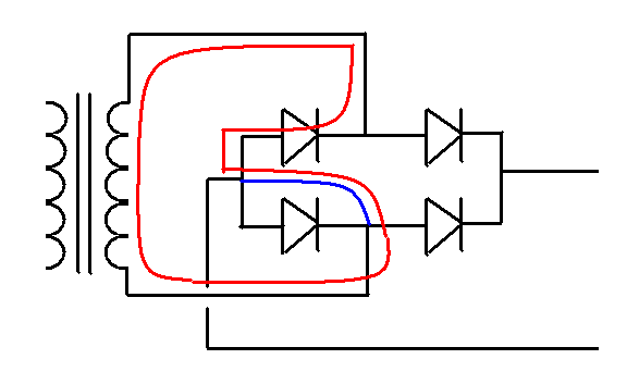

Hello there,
I am working with a transformer to take 230VAC to 18.8VAC for the first time. I am super-careful, and have placed the transformer in a plastic box, with only the leads coming out.
I connected CH1 to transformer output (18.8VAC) and CH2 and to the rectifier output (16.6VDC). I wanted to compare the voltage from before and after rectification. I could tell something was wrong because the fuse on transformer input blew (1A). And all the leads and gear were current had been flowing was very hot. The waveforms on the scope didn't look like they were supposed to.

You didn't tell us where you connected the ground leads of the scope.

Remember the scope vertical inputs share a common ground. Think about the full wave bridge with the diodes conducting on alternate half cycles of the input AC signal. If you can post a drawing of exactly what you did there is likely an explenation. If not, this thread is moot.

Ron and Duffy:
The rectifier has four legs. Two are AC input. Two are dc output. The transformer is connected to ac input.
CH1 GND was connected to one of the ac inputs, and the other was connected to the other AC inputs.
CH2 GND was connected to - on the DC output the other dc on the + output.
The transformer has fused 230VAC input (slow 1A fuse) The fuse blew every time. When I installed a 2A fused, it didnt blow.
The 1 mm^2 gauge wires from the transformer got hot. Perhaps 35*C. The rectifier was perhaps 60*C. The outside of the transformer was circa 40*C (but no idea how hot the coils were).

Referring to my attachment.
What you did was to short circuit one of the diodes in the rectifier, as shown by the blue line.
This allowed a large current to flow through one of the other diodes and the transformer, as shown by the red line.
If the transformer is not cooked, one of the diodes in the rectifier may be.
Lesson:
Be very carefull when connecting two scope probe ground clips to a circuit.
Depending on the design of the scope, the two ground clips are connected together and will create a short circuit in the circuit under test.
Always ensure that the ground clips are connected to points at the same potential.

Altohugh I have little experience in scopes... I believe the grounds of both channels are internall connected. So, what you have done is essentially connect 'a wire' from the rectifiers -V output, to an AC input. Likely shorting one of the diodes in the rectifier across the AC input.
How much current flowed through this diode is down to the rating of your transformer. Given it blew with a 1A fuse, but not a 2A fuse, I suspect its a fairly low rated transformer (12VA?).
If you want to see the voltage of the AC input to the rectifier, and the output of the rectifier, I would keep a common ground...namely, the '-' of your rectifier bridge. Both channels grounds sohuld be connected there, then you can connect channel 1 to either of the AC inputs, and Channel 2 to the rectifiers '+'.

As you're from Norway, I suspected the mains voltage would be 230V, so I'm sure you realised that for a 1A fuse to blow on the primary, it must have been carrying >230W. That said, if I erroneously assume that its 50% efficient (its much more, just for arguments sake) then thats 115W in your primary. If that was across a single diode, via the grounding connection in your scope, its arround 11.5A flowing....

What Blueteeth didn't say explicitly is that this 11.5A was flowing through the ground clips at the end of your scope probes, down the shields of the probe cables, through the BNC connectors of the two channels and then through the internals of your scope.
You could do serious damage to a scope this way. You could burn copper runs right off the PC board in your scope.
Don't EVER connect the ground clips to points in a circuit that are at a different potential.
