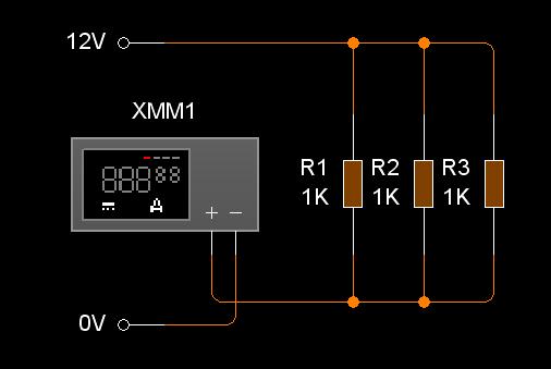

How does one, when calculating the power (watts), work out the watts produced in a circuit with parallel resistors of the same value?
As in attachment 1 (one)

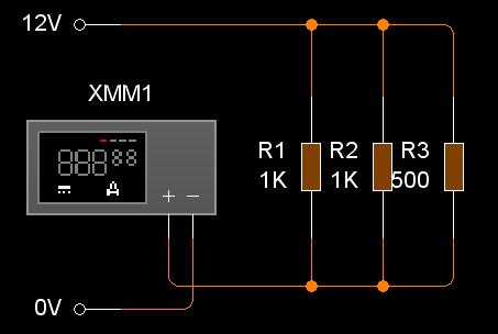

And then how do you work out the watts produced with parallel resistors of different values?
As in attachment 2 (two)

A watt is defined as the power delivered by passing one amp into a load with an EMF of one volt. Using this knowledge, you apply ohm's law to answer your question.
I assume that the meter in the attachments is an Ammeter to measure the total current.
Resistors in parallel have the same voltage across them so it does not matter whether they are equal or not. Calculate the current through one using Ohm's Law and multiply it by the voltage. Power P = V * I
The short cut is to use V^2/R. I'll leave it to you to work out how this formula is derived.
If that is the case, why is it when I simulate the circuit the 500Ohm resistor blows?
The two 1k Ohm resistors dissipate 143.93mW, but the 500Ohm resistor blows with 287.72mW.
hi skuz,
I'm assuming that when you say, the 500R 'blows', you means it burns out?
If the 500R burns out with 12vdc across it, then it's power/wattage
dissipation is under rated for a 12v supply. The other two 1K0 are not
having any influence upon the 500R.
The current flowing in the 500R is, I= V/R, so Is= 12/500 =0.024A [24mA]
So W= V * I, 12 * 0.024 = 0.288 Watts, if you have rated the simulated
500R as less than 0.5W then you could have problems.
Remember, when you do your resistor wattage calculations, to consider
the ambient temperature the resistor will be working in. Read the specs.

Yeah, the information you provided worked. I just wasn't sure that when calculating the watt output whether there was a special way of looking at it.
Like how parallel capacitors work like resistors in series.. Just strange things like that..
The math did check out. Thank You.
