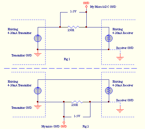

I plan to convert the 4-20mA to 1-5V, using OPAMP and ADC on PIC12f675. Because I am taping the current in between existing transmitter & receiver, so I prefer not to ground it at the middle of the current loop.
Someone tell me, I need "high side current sensing", it may be just differential OPAMP as I think, I can build a simple one, but the linearity, gain , temperature , accuracy is a big question to me as I am poor in analog circuit design. So if someone have already design the circuit for 4-20mA (which for my case) will save me a lot of time. :D
May be I shall try first before asking for it. :oops:

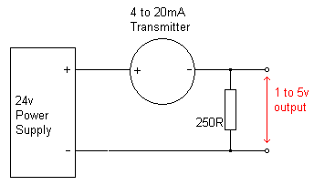

Microcontroller A to D ?
If the A to D on the microcontroller will accept 5v then can you not wire up as per the attached diagram ?
This would allow a common negative between 24v supply and microcontroller 5v supply.

Will the setup work for me? With condition, I must have good separate ground to the existing system ground.
Figure 1 requires all 3 grounds to be completely seperate.
Figure 2 does not require separation of the transmitter and micro grounds, only seperation of the receiver ground, thus I would prefer Figure 2.
