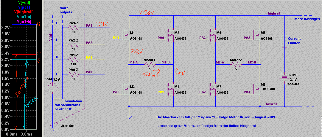

And here it is, something completely different.. A really simple low-voltage H-bridge, using 21st century AO TrenchFet Mosfets.
Directly driven by microcontroller, HC logic, 4000 series, or LVTTL.
Ideal for PWM because of high speed FET circuit.
Optimised for 2-cell NiMH motor supply (2.4 V) and 3.3 V control logic. Even lower typical voltage drop with 5V-powered CMOS logic.
Even with 3.3 V powered logic, there's typically less than 0.2V drop when driving 0.4A motor current, making this H-bridge ideal for servo applications. Although it can be lower as well as higher, if 0.2 V drop is too much, since the FETs are very cheap (£0.20 in UK) you can easily afford to buy spares and use the best ones for voltage-critical applications.
Omitted are 100K 'pull-down' resistors between the gates and grounds. These prevent the FET turning themselves on should the IC supplying the controlling signals is unpowered.
Truth table
PA0.PA1.PA2.PA3
L.....L....L.....L. ......... IDLE STATE
H.....L....L.....L .......... MOTOR1 A-B DIRECTION
L.....H....L.....L .......... MOTOR1 B-A DIRECTION
L.....L....H.....L .......... MOTOR2 A-B DIRECTION
H.....L....H.....L .......... MOTOR1+2 A-B DIRECTION
H.....H....L.....L .......... ILLEGAL (CURRENT LIMIT PROT. OPERATES)
L.....L.....H....H .......... DITTO

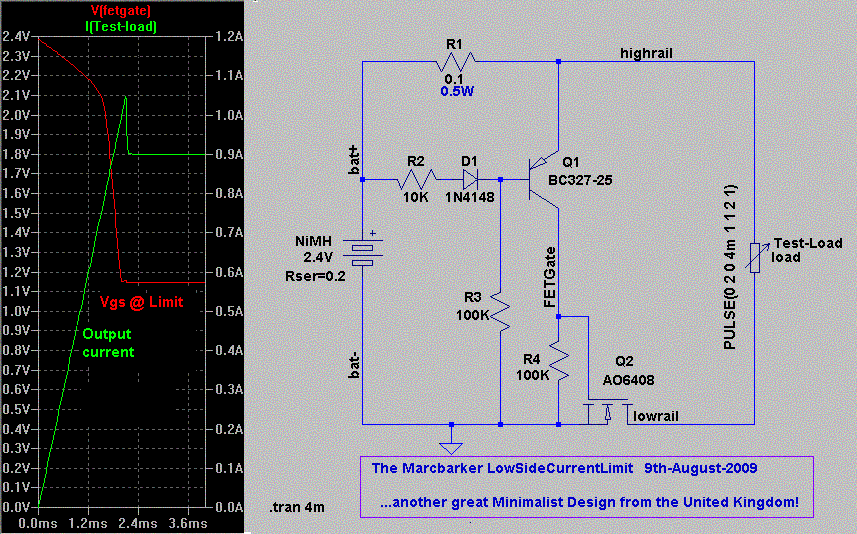

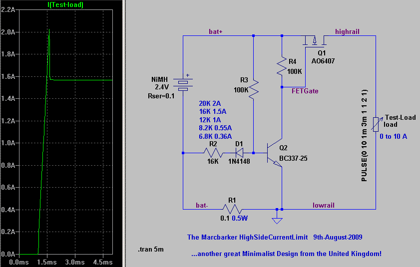

Also..... using these same FETs, two suitable current limit circuits - optimised of course for 2-cell NiMH (2.4 V) Ideal for using with the H-bridge to provide protection from bridge 'shoot-through' etc.
Here you can get a good idea of just how low gate drive voltage is typically, while the FET is current limiting at 0.9 A. Of course, this gate voltage may be lower (or higher) from FET to FET. Theoretically, it's about +/- 0.5V variation but typically it's less variation, and in any case the gate voltage is plenty low enough. As you might expect, some FETs will be better than typical.
The 0.1 ohm current sense can include any wiring, or a suitable length of wire can even be used as the resistor.
The current drain is a miserly 50 uA, making this ideal for for battery operation, without the need for an on/off switch.
Note that during current limit when there is a short circuit, the FET may be dissipating over 2 W. Without a heatsink this can be a problem if the power exceeds your derated package dissipation. One way around this is to alter the circuit slightly so that the FET latches itself off, after an overload lasting longer than a preset time, then this circuit will behave like a Polyfuse, but with lower dropout voltage for a given current.
View attachment pa0-3-fet.asc
![o-h-bridgefet.gif o-h-bridgefet.gif](https://www.electro-tech-online.com/data/attachments/28/28129-41e56e68030fd46382ffec74c31f3ac5.jpg)
View attachment pa0-3-climH.asc
![lowsidelimit.GIF lowsidelimit.GIF](https://www.electro-tech-online.com/data/attachments/28/28130-3f167b8cbb5831baf1a069edb5dd2153.jpg)
View attachment pa0-3-clim.asc
![highsidelimit.GIF highsidelimit.GIF](https://www.electro-tech-online.com/data/attachments/28/28131-95e4dfc02bf66d205570e047f99eb042.jpg)
