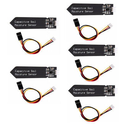

He's using an active "capacitive soil sensor V2.0" module that has an analog output when powered.
eg.
It it does not behave as expected, it may be damaged or miswired or the sensor has some storage voltage with low leakage decay time, in which case is not a problem if it does decay and there is no input current.
The sales page contains no info to describe how it works. The typical sensor does not show any schematic but it does have a 555 timer and an SOT-23 3 pin device that may be a 3V LDO to provide the sensor output. 0, 3V.
It is a moisture controlled frequency using the 555 clock when the capacitance detects water that inversely controls frequency with moisture content.
Can you see anything on the interface pin (data) under dry/moist conditions or in the info that came with the product and tell us?
