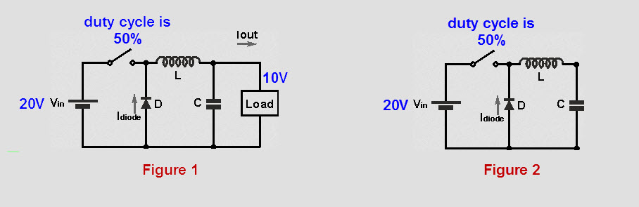

Please have a look here. You can see that in Figure 2 no load is connected across the output. Don't you think that in such a case the capacitor's voltage would keep on increasing until it equal the input voltage, i.e. 20V. Do I have it correct? Assuming I have it correct, how is this handled for practical buck converters? I understand that a feedback could be used but I think it would require to decrease the duty cycle , or is there any other way to limit the output voltage to around 10 V? Could you please guide me?
Thanks a lot for your help

IF the duty cycle was locked at 50%, there is no voltage regulation whatsoever and the output depends on load, component resistance, input supply etc.
In reality, the duty cycle is regulated to hold the output voltage constant or as near as possible. The duty cycle would drop to zero with no load.
With no load Vout goes to Vin.
if the duty-cycle can go to zero.
Because switches (in the real world) are not perfect, some current might leak through and lift the output. On the other hand the capacitor will leak and pull down a little.
In real power supplies there is a feed back loop that will force the duty cycle to zero if the voltage gets even the smallest amount above what it should be. Also there is a resistor across Vout in most power supplies. It helps discharge the capacitors when the input power is turned off. It also gives the supply a minimum load. If you are having problems thinking about "Vout too high" then put a Zener diode across Vout.

No, that's a very bad idea.
It would dissipate a lot of power, and thus defeats\ the purpose of the converter to generate a voltage with high efficiency.
Virtually all buck regulators control the duty-cycle with feedback to regulate the duty-cycle.
Some types change both frequency and duty-cycle (such as simple hysteretic (bang-bang) feedback regulators.

What really confuses me is that when talking about a buck converter's output, no one ever talks about a feedback loop; voltage or current sensors.
You are in a text book. (theory) They are working on duty cycle to output formulas. You have not seen a complete power supply.
Here is the Switch=FET, Diode, L, C and load.
Added is an error amplifier. In this case it is looking at a fraction of Vout and compariting it to a reference voltage.
The output of the error amp makes a voltage that with a sawtooth wave form creates a duty cycle.
If Vout is not right then the error amp amplifies the error, with delay & phase shift.
The output of the error amp adjusts the duty cycle. (closed loop)
