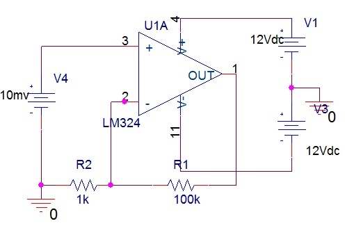

the problem is amplifying the 1mv voltage with lm324
faraday
Hi
I wanna send the output of a thermocouple to a micro but the
thermocouple voltage is maximum 3mv. I used lm324 Op-Amp for amplification. This
circuit works in simulation but practically there’s no output (Vout=0)
What’s wrong?
What kinda changes are needed to amplify this little voltage
(about 1mv) and rise it to 4v?
The LM324 is not suited to measuring such a small voltage, because its input offset voltage can't be nulled and swamps the voltage you are trying to measure, driving the output hard against either power rail (0V in your case). You need a precision op-amp (google for that) with offset-nulling capability.
There are several things you need to consider to amplify the output of a TC. There are precision instrumentation amplifiers designed just for that purpose. The AD594 and AD595 come to mind for a Type K TC.

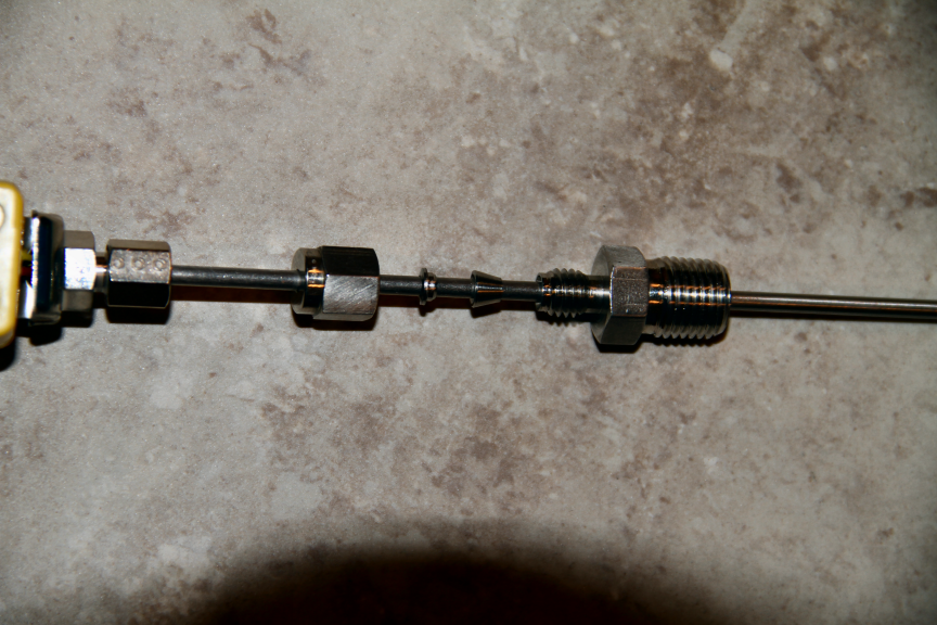

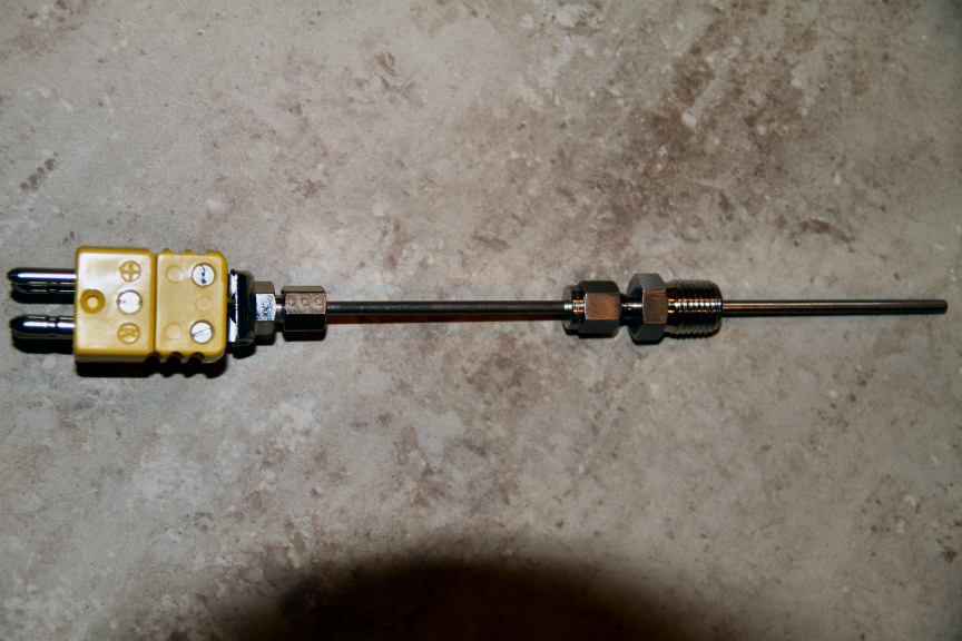

Attached are a few images of a Type K TC. This one is a 6 inch inconel sheath (pretty common) with a compression fitting. You can see the compression fitting on the TC sheath plus the compression fitting open. This is how thermocouples are generally inserted into a tank with as much TC protruding into the tank as you wish. The TC is 1/8" OD and it is a 3/8" NPT pipe thread for the tank.
Actually with some doing the LM35 can be waterproofed but given a choice the TC is a good way to go. Read the data sheet carefully for the chip as to connecting things. Some of the data is important as to good accurate measurements.
