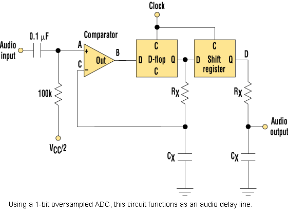

I'd like to have a go at building some very straightforward audio delay circuits. No variables, just a fixed time delay (upwards of 1 second) which I assume is achieved with resistor values, and continual one time playback. Does anyone know a good source of simple schematics for this?

I take your point, but I am not necessarily interested in reproducing the sound with any attention to fidelity. Could I not make a test circuit with a 1-bit adc and replace it with a higher bit one if I can get it to do what I want? (I am assuming bits and £s are closely connected)
A 1 bit ADC means its a form of PWM input to a digital output.
I would suggest something more straight forward if you're studying electronics.
Yes, you need some sort of serial digital bit stream. That's what the note "Using a 1-bit oversample ADC" on your schematic means. The "Audio Input" is from the A/D converter. If you just feed audio directly into the circuit, you will get something that has little resemblence to the original audio.
1-bit does not mean low fidelity, it just means the information is in a single bit-stream. This can be a 1-bit ADC that gives a PWM signal as described by blueroomelectronics. You could also use the output of a standard A/D converter that has a serial output. If you wanted to listen to it after the delay, you would have to convert it back to analog by passing the output to a serial input D/A converter.
A PWM signal can be converted to analog by passing the bit stream through a low-pass filter and amplifying the filtered signal, since the signal has an average value equal to the orignial digitized signal. For best response a high order filter is needed, but a simple 1-pole filter will give a useable signal if you don't need maximum fidelity.
The circuit is a simple delta-sigma ADC, but there is an error in the schematic. IIRC, this was originally published in EDN Design Ideas, and was subsequently corrected, but errors live forever on the Internet.
With the correction (see attached), it will work as a crude ADC, and audio (not another ADC output) is the input signal.

Ron is right of course. Should have taken a closer look at the schematic to realize something was wrong with the original.
Do you know what clock frequency was recommended?
I don't remember the clock rate. I ran a sim on it this morning with Fclock=100kHz, and RxCx=100 usec. It looked OK to around Faudio=5kHz. I didn't try running the sim on a WAV file and then playing back the result (which you can do with LTspice by jumping through a few hoops).
Found the article. It was in Electronic Design **broken link removed**. The clock and time constant suggested was the same as Ron used.
