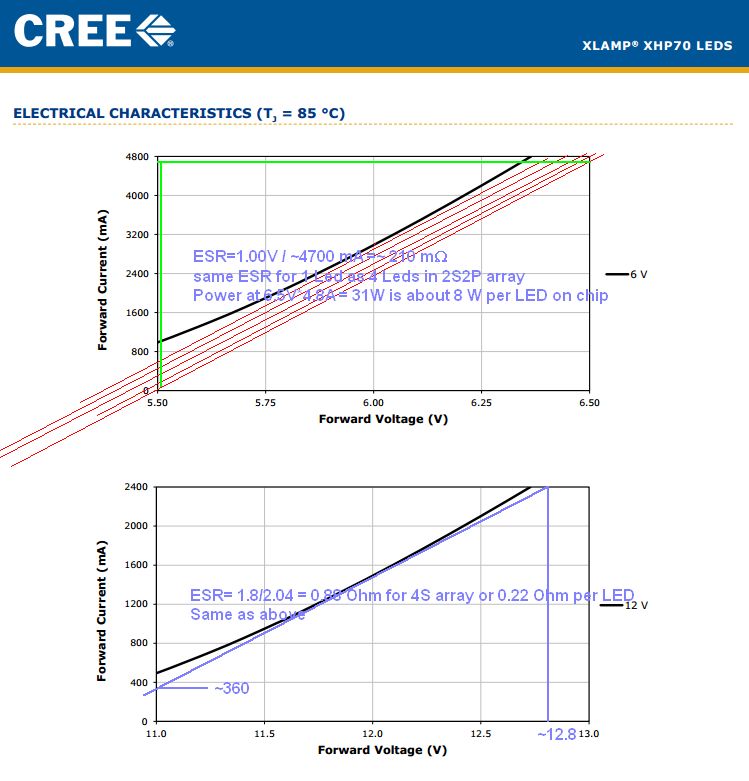

Below is a new high power Cree array of 4 LEDs either 6 or 12V option, 130 lumen / W
Note the slope is ESR
so as slope with current rises, ESR drops a bit
They often spec Vf at @If @25'C as the test is done in milliseconds with a pulse.
