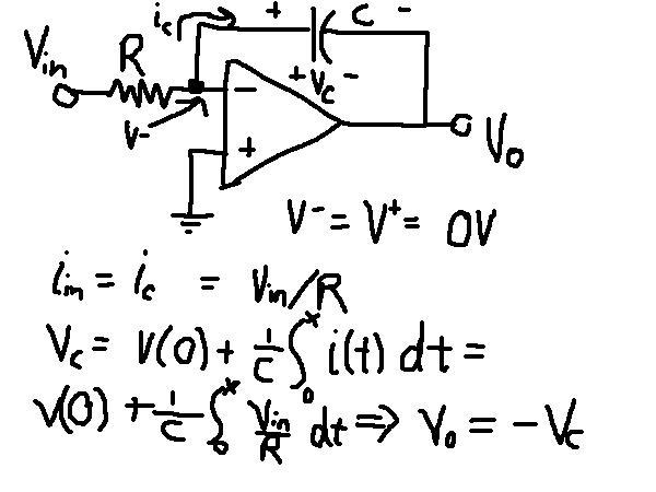

For analysis purposes, you must assume that the voltage is the same at both the negative and positive terminals of the op-amp. Thus, the voltage at the negative terminal is what we call a virtual ground or 0 volts. I will label the negative terminal "V-". By nodal analysis, we know that the currents going into the node V- is the same as the current leaving the node V-. Hence, the current entering the node must be the same current going to the capacitor due to the virtual ground.
Due to the virtual ground, the negative voltage across the capacitor is the output voltage Vo(passive sign convention). The voltage across a capacitor in general is V(t=0)+1/C*Integral(i(t)dt,0,x). Substitute i(t) = Vin/R and you have your theoretical integrator. I have attached the work I did in MSpaint. I hope you can read it and it makes sense.
Of course this is theoretical and will not work in practice. You need a feedback resistor in parallel with the capacitor to get it to work if I remember correctly. I'll hopefully post on this part after dinner if no one else beats me.
edit: The reason you need a resistor in parallel with the capacitor is because any DC input offset will get integrated over time and saturate your amplifier. The basic rule for choosing this resistor value is: Rf >> 1/(2*pi*f*C)

A resistor in parallel with the cap, or some sort of reset, is needed in an integrator that is not within a larger feedback loop. In some cases, such as a so-called "function generator", the integrator is in a feedback loop with a Schmitt trigger. In this case, no parallel resistor is needed, because the Schmitt trigger automatically inverts the polarity of the input voltage when the integrator's output reaches defined +/- limits.
