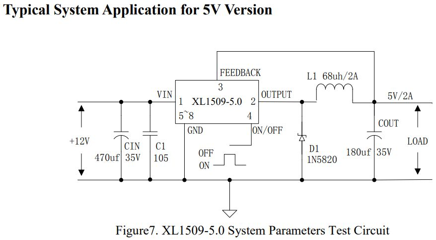

Hello,
I am trying to wire this IC to my circtuit for reducing voltages from 12V, so good to understand the purposes of those elements. And the nominals for them choosed, because for 3,3V option there is bigger Cout capactior and more less L1.
Also I am not sure about needance of D1, is it for reverse current protection?

D1 is sometimes called a "catch diode" in that it conducts when the voltage on the left side of that inductor tries to go negative and thus still allows the inductor to provide a positive output during that time. This is the time then the internal transistor turns off.
This is typical for the usual buck circuit. It does have to be a high speed diode like a Schottky though.
D1 is needed to provide a path for the current when the switching device in the XL1509 switche off. During the time that the switching element is off the stored energy in the inductor powers the load. I suggest that you google "how switching regulators work."

D1 is necessary for the proper functioning of the XL1509. It is not for reverse current protection but is instead part of the switching regulator's operation. Omitting it will prevent the circuit from functioning as expected because the inductor requires a path to maintain current during the OFF phase of the switching cycle.
Note that the XL1509-5.0 is designed for 5.0V output. If you want 3.3V out, use the XL1509-3.3 version. There are also -ADJ and -12 variants.
I think it's something similar to the flyback diode for protection from reverse current. And according to symbols, there is Schottky diode.

When the transistor internal to the IC chip turns on, it pumps current through the inductor. Some of that current charges the capacitor, some goes right to the load. That puts some voltage at the output to power the load.
When the internal transistor turns off, the inductor wants to keep pumping that current to the output. To do that, the voltage across the inductor flips so that the left side becomes negative. To keep the current flowing, the diode allows the current to keep flowing from ground through the inductor to the output. That helps to maintain the output voltage and keep it somewhat smoothed out.
This also partially 'resets' the inductor getting it ready for the next 'on' period of the internal transistor. Once the transistor turns on again, the cycle repeats.
If the diode was not there the inductor would not have a discharge path when the transistor turns off, so the circuit would not be able to function properly.
