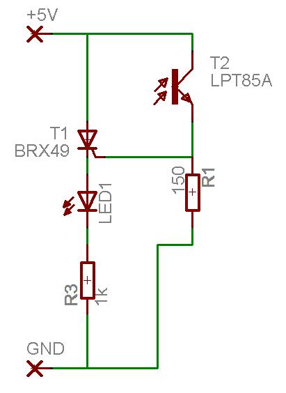

I've bought a couple of thyristors to use them as signal triggers, but I can't get them to work!
First, I know that thyristors do have an anode, a cathode and a base. But when looking into the documentation of the one I have (BRX49), I find that:
Pin 1: anode
Pin 2: anode
Pin 3: cathode
So how do I connect it???
Also, I've tried to do the following circuit, assuming pin 2 to be the gate, which does not work (even though I've measured the voltage at the gate, and it goes from <200 mV to ~2V when it detects a signal). However, the led stays off...

hi gonzalo,
Even though the gate voltage measures 2v or so to ground, it will not be so if you measure from the gate to the top of the LED connected to the SCR.
Place your LED and resistor in the 'top' line, apply the 2v to the gate and ground.
Eric
The LED won't turn on until the gate of the SCR reaches about 2.6V (depending what colour LED you used).
150:ohm: is a bit large for R1 and R3 is a bit too big for an LED. R1 shoud be around 10k and R3 should be around 270:ohm: to 330:ohm:. Check the minimum holding current for the SCR, it won't stay on if the current falls below below a certain value.

Hi;
A problem using SCR devices in DC applications is in how to turn them off once they fire on. Your circuit once fired on will stay on forever until you remove Vcc from circuit, as the base then has no further control of the device. Should be plenty of info via google on using these devices.
