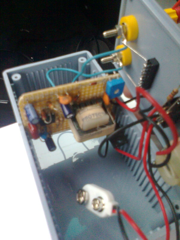

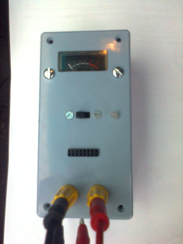

Finished my simple little ESR meter, the only thing not salvaged really is the box.
The box is a PX2, I think its made by hammond, I got it from maplin electronics here in the uk, I dont shop there often, the mrs was shopping in the same centre that day.
The transformer was robbed from a pc power supply, the actual type isnt critical as long as it doesnt have an air gap.
Its very usefull for repairs as the output is only around 250mV so it doesnt make semi's conduct so you can test caps in circuit, the only time I've needed to pull them is when they are paralled up.
