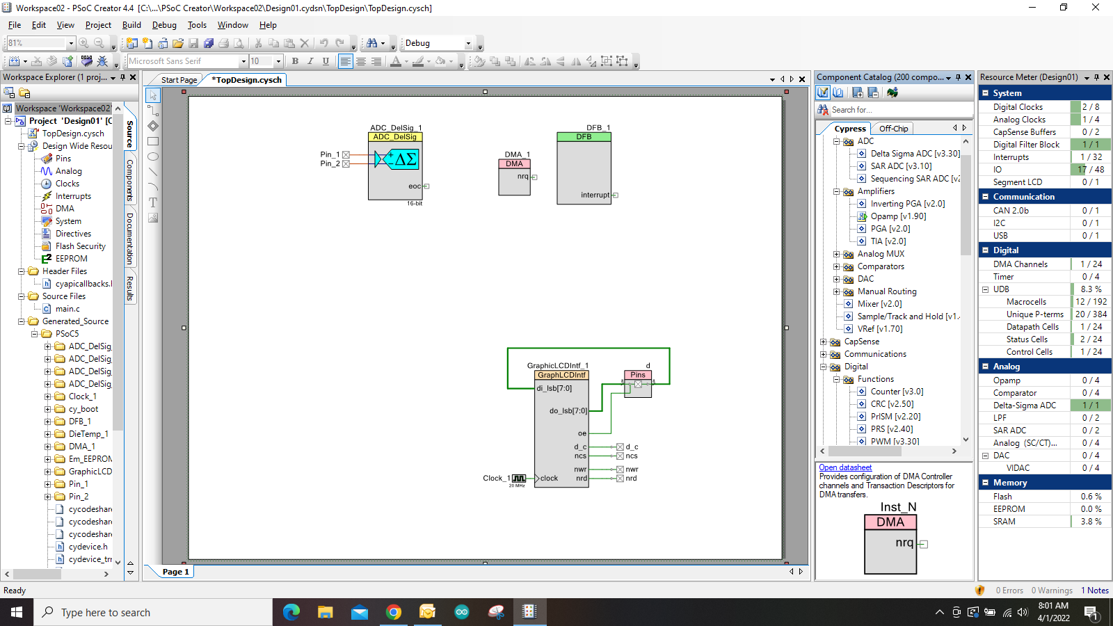

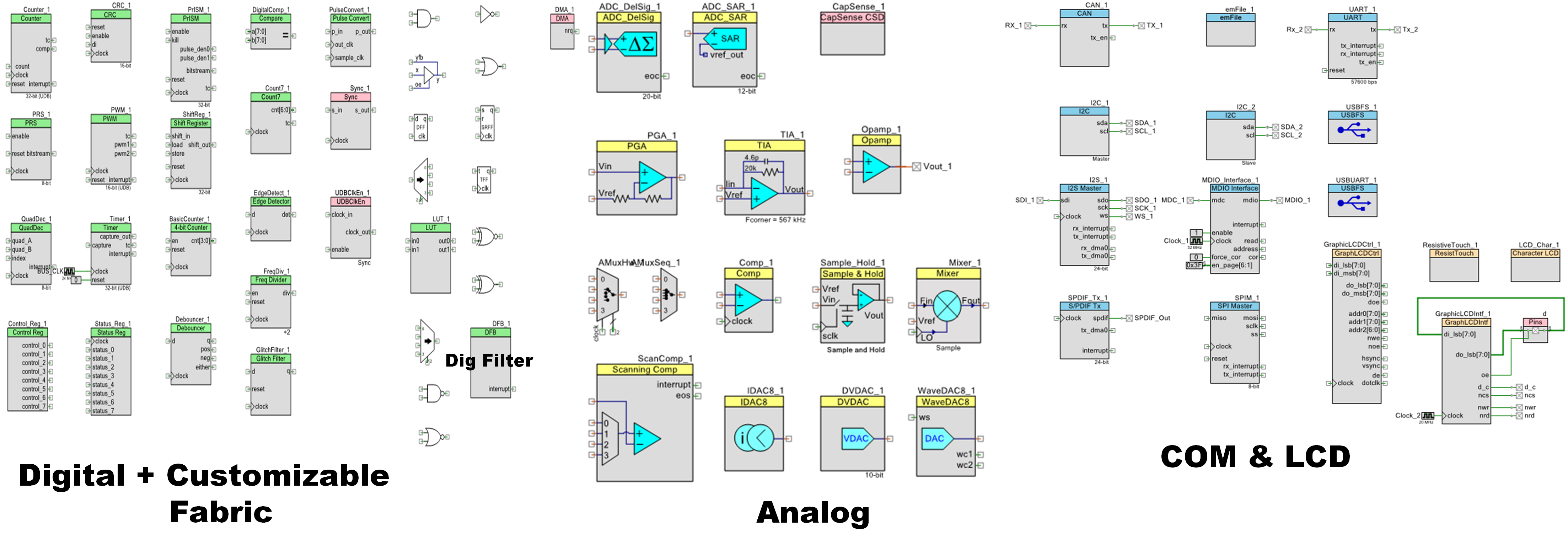

One possibility, may resources onchip still left to be used. One chip.
Core is ARM M3 onchip.
Basically a DelSig, up to 20 bits, differential input, should eliminate need
for external amps. And input stage has programmable amp input. Vref
+/- .1% onchip also.
Other stuff onchip :
Right hand window shows resources used/left. IDE screenshot above.
Board ~ $15. Includes debug. IDE (PSOC Creator) and Compiler free.
Regards, Dana.
Regards, Dana.
