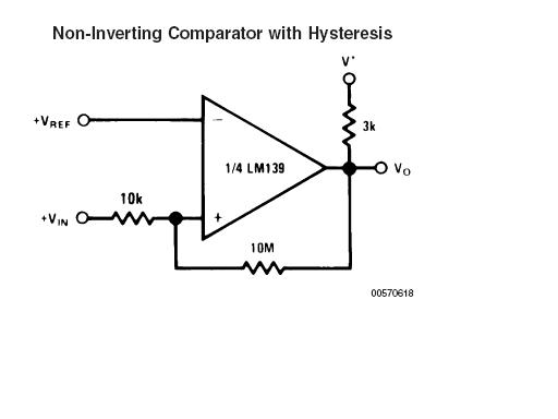

I have several ntc thermistors 100 150 200 10000 ohm. I am trying to use the thermistor to control power to a led. So when the thermistor cools slightly
the led flickers. (just like blowing on a candle). I have tried wireing in many different configurations with no sucess. It was sugested that I was saturating the thermistor with current but I have not been able to get it to work. I am a
beginner when it comes to electronics. any help would be appreciated.

matt using a LM139 is a good place to start ..
someone could probably draw you a complete circuit..
but the idea is, set up your reference input with voltage divider to say 5V
then use your thermister to vary the resistance in the leg connected to the Vin input..
when your thermister encounters heat the resistance changes and turns on the comparitor; with the comparitor on you would have to drive a transistor gate of a FET becaue the comparitor cant drive the LED directly , actually it probably could since it has short circuit protection..but in any case it can only provide 16 mA and you would like 20 mA..
Im not sure but wouldn't the comparator give the led a on off (digital) effect.
If the thermistor is blown on the temp goes down and I would like the brightness to also go down. Kind of an exponential decay rather than a on off effect. just like a candle.
