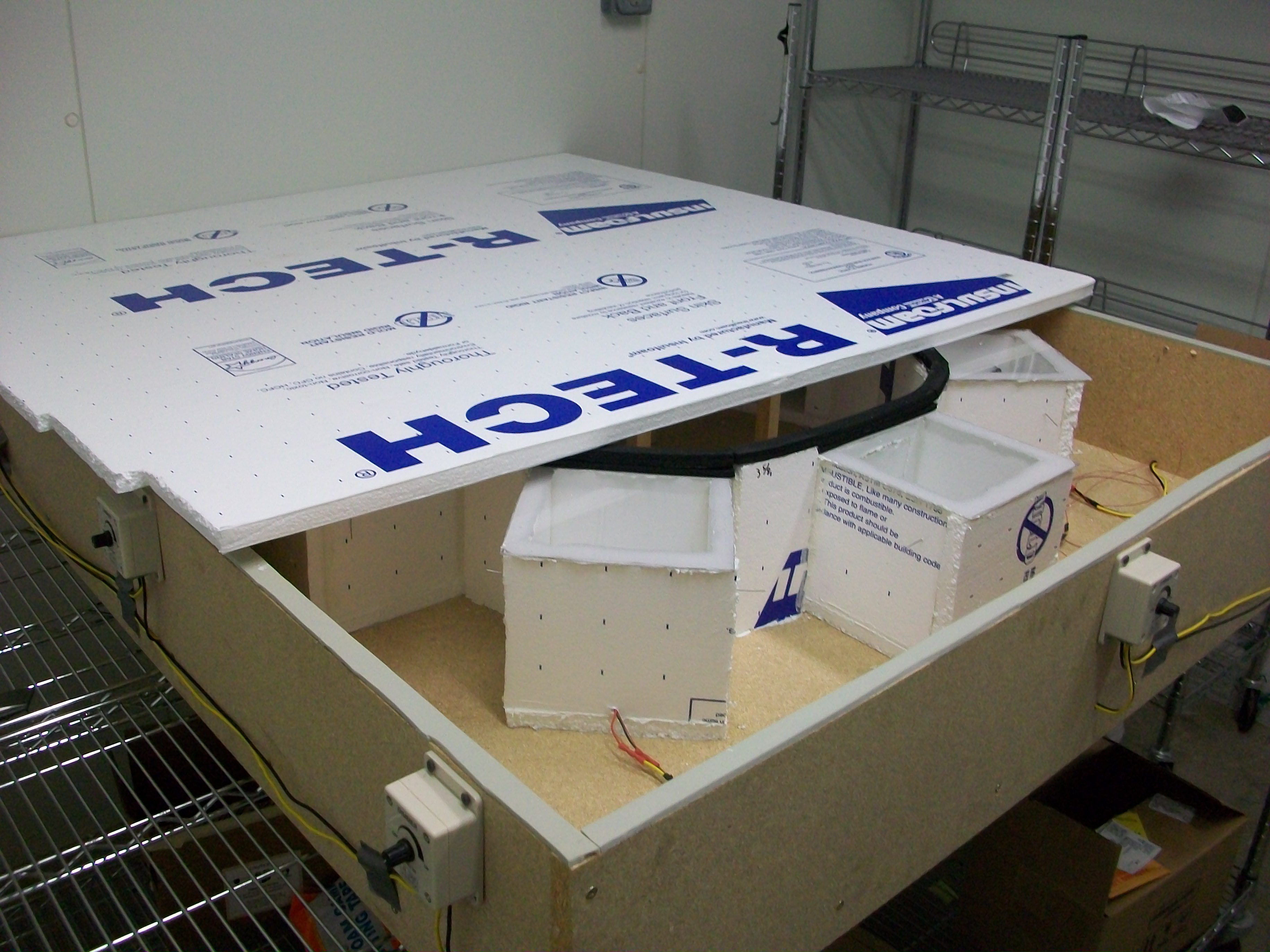

I've been tasked with building a thermocouple setup to control the temperature of growth chambers for a entomology project. I have almost no experience with electronics. For the project, we have 8 or so insulated chambers in which metal plates will heat up petri dishes that the insects have colonized. There is an optimal range in which each chamber will be maintained. These heating plates are already each connected to a set of thermocouples. So I'm trying to figure out how to connect the thermocouples to the controller (Omega CN1507 Multi-Zone Ramp and Soak Controller) and to the relay device (Omega Universal Relay Module). Anyone have any ideas?

The thermocouple leads exit the square plates at the back corners facing away from the front of the chamber and the wires exit the chamber at the back. All the chambers are made of styrofoam insulation and are arranged in a circular pattern facing one another encased in a larger wooden case. The thermocouples are Type T thermocouples.
I had not originally set up the beginning part of these growth chambers. I think that the intent was to heat the petri dish directly rather than the chamber considering it is made out of styrofoam. In effect the dish will heat the chamber anyway but the actual controls will be govern the metal plate's temperature. I can post a picture of the entire setup tomorrow if that would help.
A picture would be nice. OK, type T is no problem and for low temps is a good choice. We will need to interface the controller outputs to the heaters. This is where we need to know the heater plate(s) voltage and wattage or current. That is important. Connecting the thermocouples to the controller will be no problem as long as the leads are long enough. Get the heater plate data and tomorrow I'll give you some ideas.

The hot plates are actually just two metal plates that appear to be glued together with caulking or something. The thermocouple is wired straight in between the two plates. And actually, the thermocouple wire is connected to a dimmer and then the dimmer will be connected to the control box. So I'm not actually sure what the voltage or the current is for the plates. I could not find any documentation for it. The dimmers are 12V 0.8A. Other than that I don't have any info on the the heating plates. I'll post a picture sometime today.
OK, then we can assume these low temperature plates obviously draw less than an amp at 12 volts. The dimmers were the original temperature control method. Looking forward to seeing a few pictures.

Pictures uploaded!

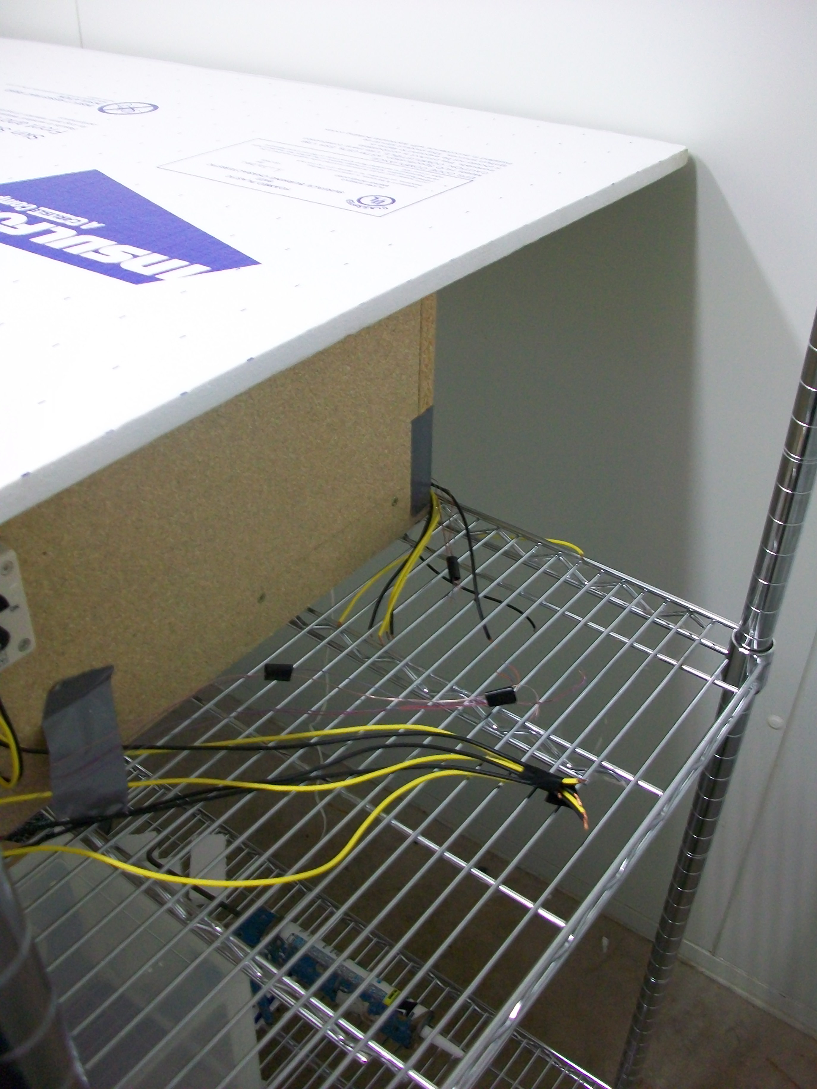

Whole Setup:

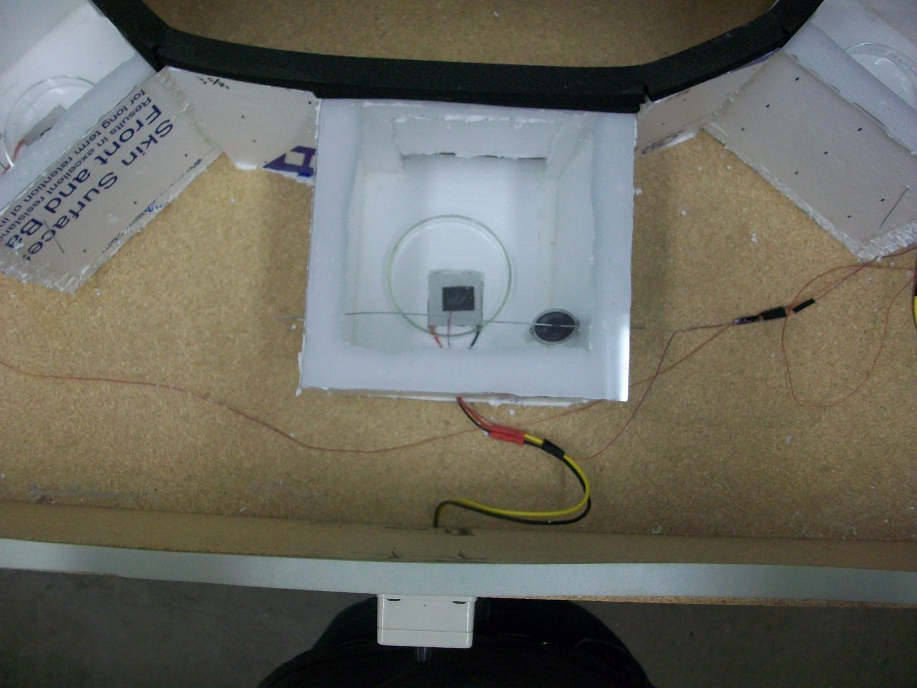

Chamber View:
Thermocouple lead ends:

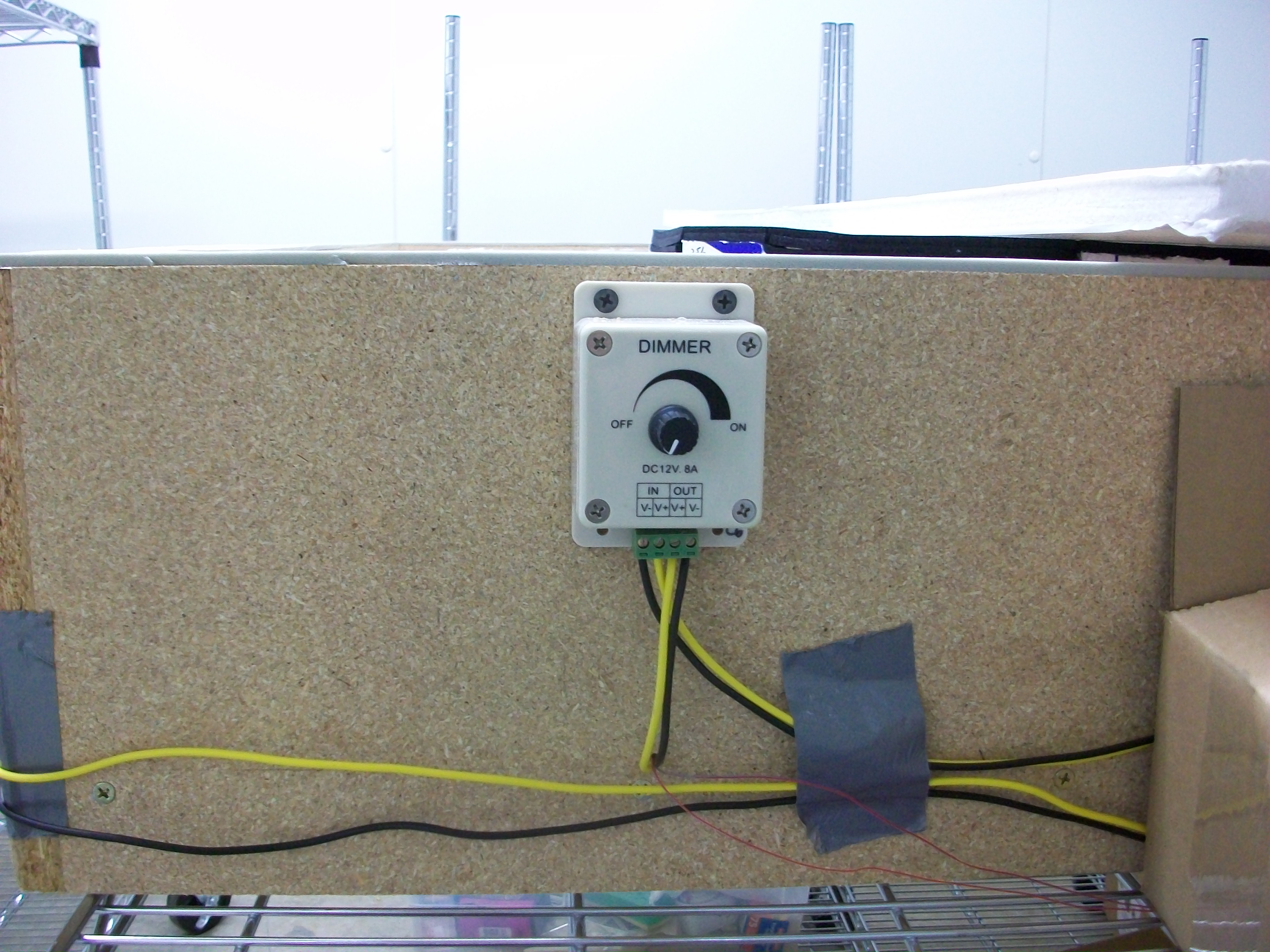

Dimmer:

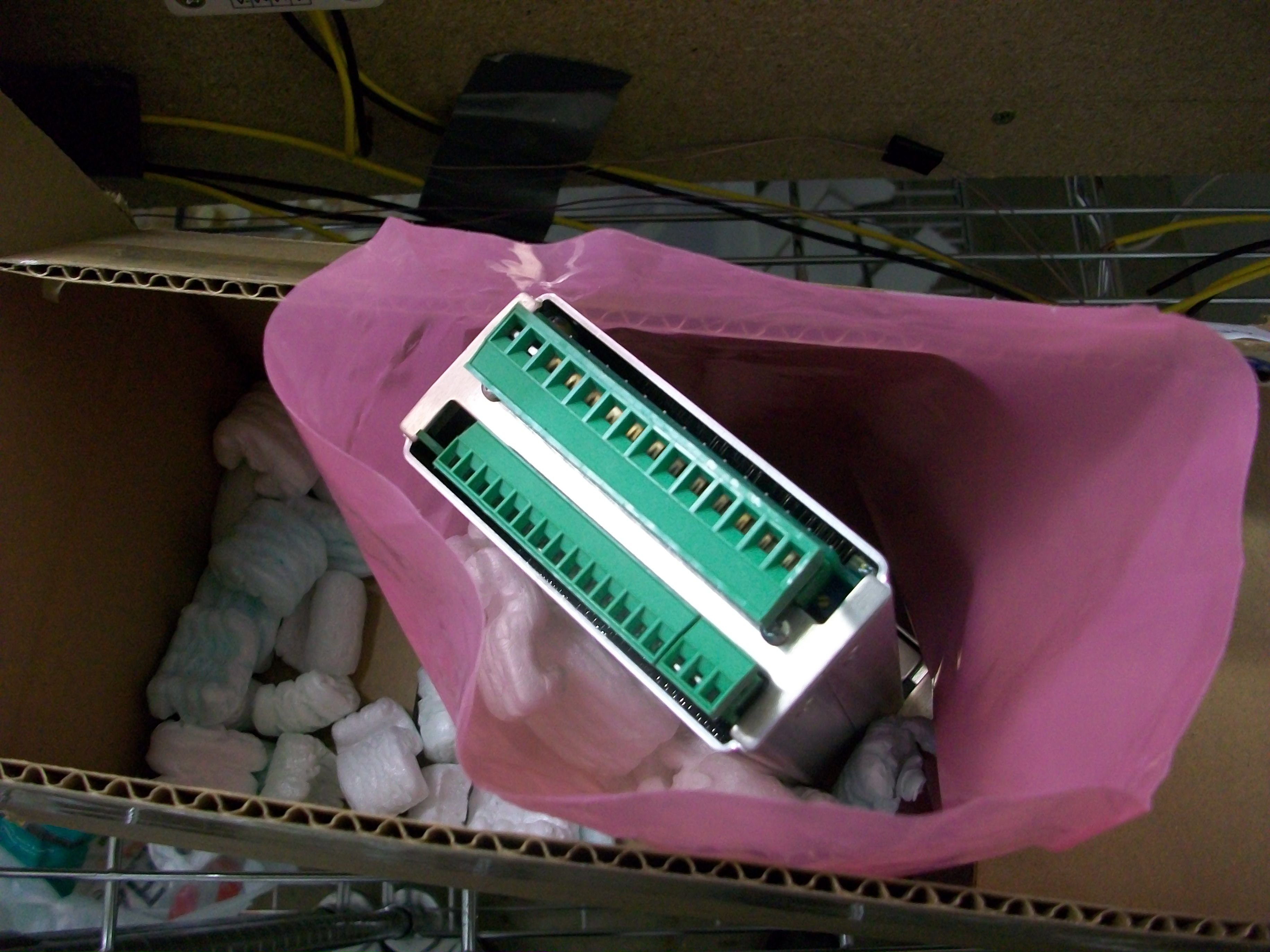

Controller:

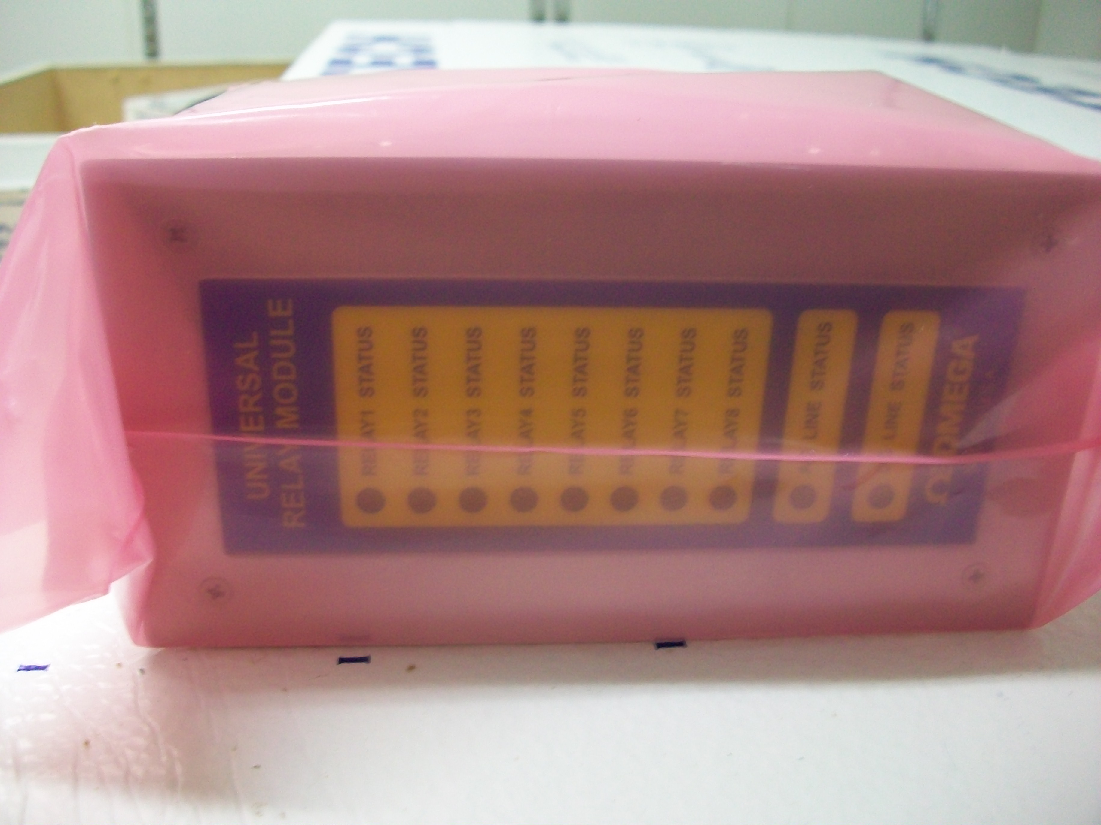

Relay:

OK, great images. You caught me in Conn on the road. The TC wires are obviously the very fine wires. What I can't see is they look to be red and white which would be common for a J type but you should have T type and that would be more commonly Red and Blue. What colors are they and you are sure about type T correct? Anyway, generally the with thermocouple leads the Red is generally Negative (-).
Originally the system was intended to be used with the 12 volt dimmers. Looks like each dimmer supplied two heater elements. Now I saw the Omega relay system, what is the part number?

I think you're right about the dimmer supplying two heater elements. The relay system is a Relay-URM-800. I should be more responsive in the coming weeks.

1) The dimmer is located here: https://cgi.ebay.com/12v-12-v-LED-s...US-seller-/360276691806?pt=LH_DefaultDomain_0 Looks like a PWM controller for 12V DC

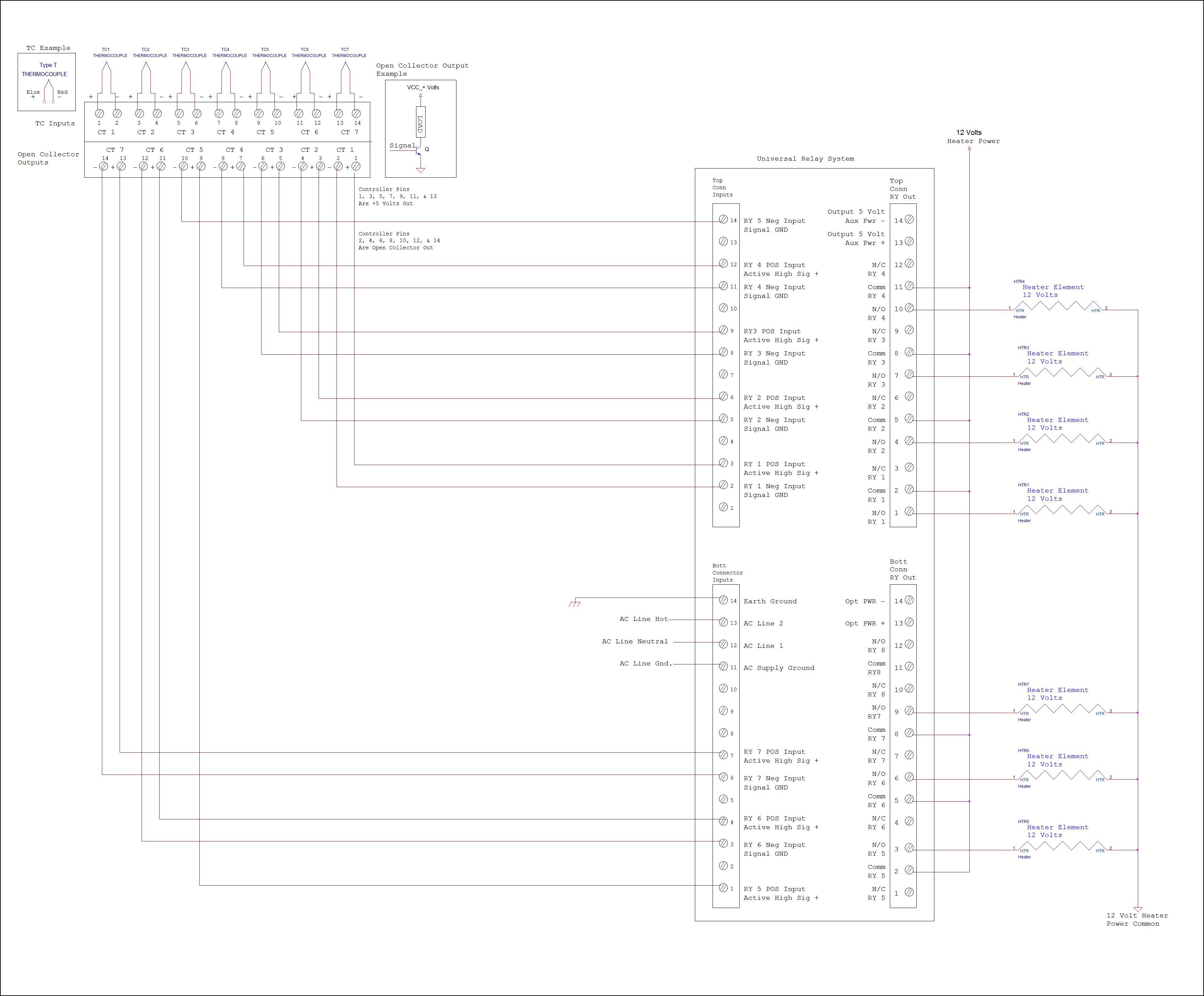

I'll have a basic drawing for you by tomorrow afternoon (Sunday) build around what you have and how I would think about doing it.
Ron
Attached is a basic circuit drawing (cartoon) of how I believe you want to set things up. Sorry about the size. As to the heater power, I drew it as single supply. I am not sure how you were supplying the dimmers? If you have a supply that was supplying the dimmers, then we can use it. I noticed the dimmers were DC in and out.
As questions arise, let us know.
Ron

The dimmers are DC in, PWM out.

I figure it this way KISS. Looking back at the posted images there is one image that shows what looks to be a tiny (as in real tiny) heating pad with a petri dish sitting on it. There is also what looks to be very, very fine thermocouple lead extending from the center. That would run with the poster's description. I agree a simple approach would just be to PWM the pad and look for the "sweet spot" while monitoring the temperature.

So here is a description of the entire system just to help clarify. In the images of the whole system, the very, very fine thermocouple wires extend out of the center of the heating pad. There are also a set of black/red and black/yellow wires that run from the edges of the plates out of the box and into the dimmers (to be honest, I'm not sure what the dimmers are for). From my understanding, the thermocouple is not what is controlling the temperatures, but rather what is measuring it. Is that correct?
That would leave me to believe that the larger wires connected to the dimmer would control the power being supplied to the plates.
Also, if someone could explain what the function of the controller and the relay are in general that would be helpful. I literally do not know much of anything about electronics so if you could spell it out in laymen's terms as best as possible that would be helpful. Abbreviations and acronyms are hard for me to understand aside from AC and DC. We actually do have a DC power converter that plugs directly into the wall socket which makes me wonder if we even need the relay module at all. To me it sounds like the relay is just to drop the voltage from anywhere up to 250 volts back down to twelve. Is there a way I can just plug the DC power supply directly into the controller without the need for the relay?
The DC power converter wall plug has two wires, one brown and one white, but I'm not sure which wire is positive and which is negative.
If I do still need the relay module, then I can still use the diagram showing the thermocouple leads going into the controller. That part makes sense to me. What kind of wire runs from the open collector outputs to the relay though? I don't think I have those wires.
