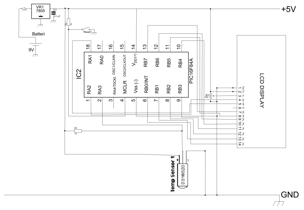

Hi, I need help programming my homebuilt thermometer. I am not sure how to connect my lcd display, but you can see a drawing of my circuit.
It is basically the same as Digital thermometer projects with PIC16F84
I am using MPLAB as compiler and i need to get the converted ASCII values written on the display.
