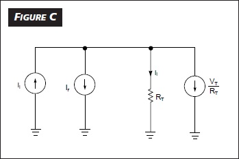

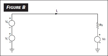

Hi All,
I cant figure how the author of the paper got Figure B (Thevenin Equivalent) and Figure C (Norton Equivalent) from circuit in Figure A.
Please help explain.

Page 3 of you referenced article explains how to determine the reflected, and termination voltages of a transmission line from the incident source voltage. These are then used to generate the Thevenin or Norton equivalent circuits.
Do you know, in general, how to generate Thevenin or Norton equivalent circuits of a network? In not, Google should help.

Dear Carl,
About Figure B
I understand that the voltage at the end of the transmission line will be the incident voltage minus reflected voltage. So Vth = Vi-Vr
Also, after shorting the voltage source. Rth should be the parallel of Zo and Rt. Thus Rth = Rt//Zo
Not sure how this results in figure B.
Please help,
ShiftyMongoose
