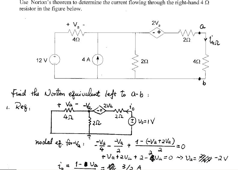

i'm thrown in to confusion........
are these right?
1. if there are only dependent sources, then must use a test voltage or current source in order to calculate R(T) = V(test)/I(test).
2. if there are both independent and dependent sources, then compute R(T) from V(oc)/I(sc).
the reason i'm asking is that i've just seen an example where (after replacing independent voltage source with short, current source with open and left with only dependent source) test source was applied in a solution.
any help in clarifying these?
Please post an example simplified schematic.
tman, you are trying to find the equivalent resistance and that is all?
answer at your qustion
friend
for this circuit you want the equevalent so remove all the source and R load after do this clc the RN = 3.3 ohm
when you want clc conect betwen a and b by wire short circuit after that there are tow sources all the sources will product the current in the R2 ohm
bu the souperposition therom consider the 12 v the current number one is 1.2A the current number 2 is 2.4 A
the INORT is 1.2+2.4 = 3.6 a
