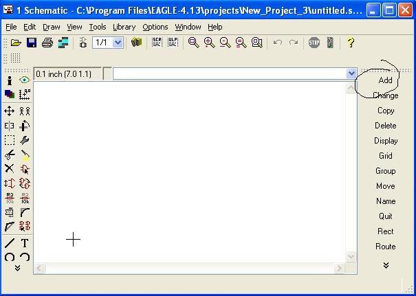

ok once loaded
1) click on file.
2) select New.
3 )select schematic
4) go up to add

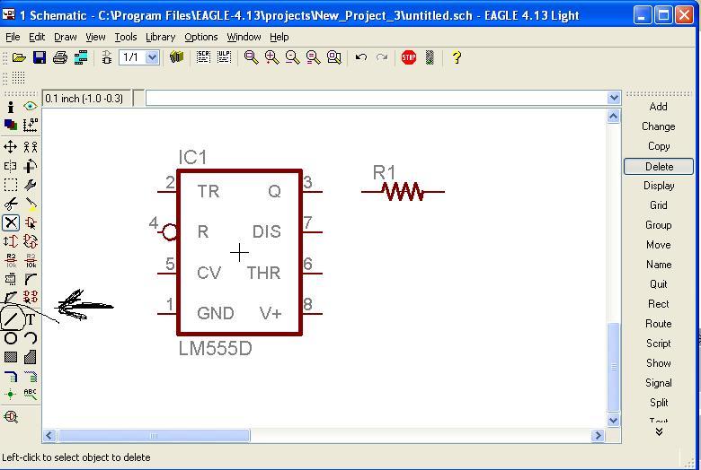

Type in what you are looking for Such as
Timer , or Resistor or capacitor..click OK
after you select a part and place it by left clicking On the Area..
i like to click delete which drops the part..
at this point after you select timer and resistor
Click Wire circled with arrow..
after you click on Wire
Click near a pin , double Click to Stop or drop the wire..
it takes a little getting used to , but once you get the hang of it , it is a great program..

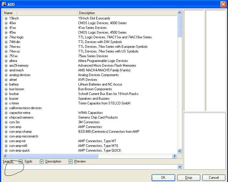

Most parts you are looking for are in there .. in the ADD.
try to describe what you are looking for , without using numbers..
for example
typing in 74138 produces no results..
but typing in Decoder gives you a whole list of them..

EDIT: I looked at it again, and you are connecting your components with the Wire function, when you should be using the Net function. I'm not certain what the exact difference is, but supposedly you should use Net rather than wire. (the faded greeny symbol 3 icons down and 1 to the right of the Wire symbol)

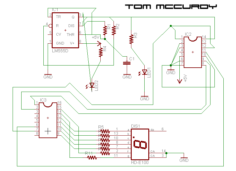

Alright I attempted to make a schematic for the circuit I built that counts with an LED up to 10.
I was wondering how you would optimize the circuit for the board. I am trying to switch it to board so I can build it.
I am going to upload the .sch file I used to make it.
  • tom.sch
Is it for veroboard?
He means do you want the board to be created for a standard PCB, or will you be doing the final hardware on veroboard, or perfboard, and wiring it all together yourself.
A couple things about the schematic. You need to actually bring power and ground in from somewhere on your board. Usually a 2 pin header or something. That +5v and GND symbols on the schematic are more like labels to make sure your putting everything to the right place. It's fine for a schematic only, but if you want to transfer this schematic to a board, you'll need a power header.
Place a header on the board and send 1 pin to the +5v net and 1 to the GND net, then select File / Switch to Board. Place the components in different positions and see how the wires go. You can moves things around until final wiring looks like it will be most direct.
