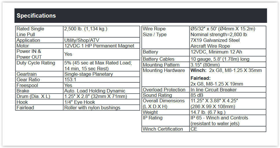

I bought a 12V, 12Ah winch but I want to plug it into a 110V wall socket. Can anyone recommend the proper converter I would need? Thank you very much.
Hy Felly,
Welcome to ETO
I assume that when you say that your winch is 12V, 12Ah, you mean 12V, 12A.
In addition to Ian's suggested power supply, which is an integrated approach and would involve little wiring, here is another suggestion. If you have no experience of electronics you would need to get someone with the right skills to fit a mains lead and a lead from the power supply to the winch. This power supply would also need to be put in an appropriate case with adequate ventilation for cooling. Note that neither power supply is suitable for exterior use.

The specs clearly state 12Ah which confused me a bit. The winch is made to hook up to a atv (vehicle) and I want to use it for a home project. Btw I'm from California. I'll try to figure out how to update my profile. Thanks.
No they don't. Not for the motor. They say that in order to run the motor you will need a 12V BATTERY with a MINIMUM capacity of 12Ah:

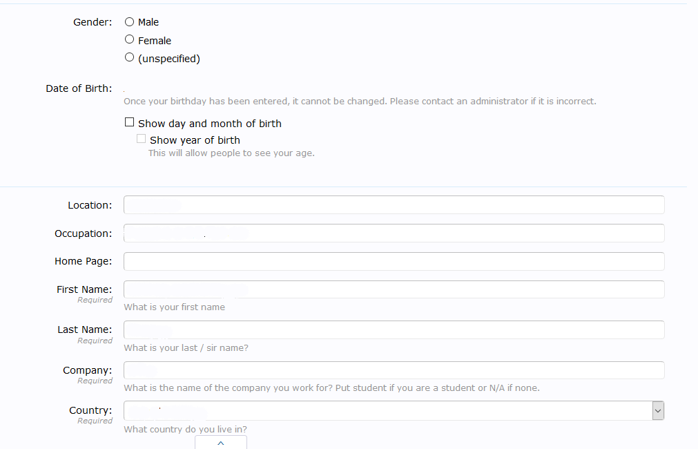

All you need to do is to left click on 'Personal Details' at the left of your user account home page and put in 'California' against, 'Location', as shown in the attached image. Your location will then be displayed in your identification window at the left of your posts.

I think what we are saying in laymans terms is that if you were using this tool with a battery alone, it would need to be a 12ah one, or about 1/3 the size of an average car battery.
The actual current pulled by the winch motor will be more, much more, this is justy a educated guess, but spose the winch is 500kg and its moves fairly slow the motor would be in the region of 350 to 500 watts, which is about 30 to 50 amps, and if you were to stall the motor maybe 4x that.
I suggest you call the manufacts and ask them how much current is uses.
One way to solve your problem cheaply, and if you were not using the winch for long periods is to have a battery connected to a charger to supply it.
Hi Felly,
This page from the manual states that the motor is 1 HP.
1 HP is equivalent to 746 watts (From memory.) so at 12 volts this 747/12 = 62.17 amps. That would be if the motor was 100% efficient which it will not be. So if it was 80% efficient this would be 62/0.8 = 77.5 amps. These figures will be if it was fully loaded. My guess would be that it would probably take 20 amps on very light load. I think powering it from a small car battery that is on float charge would be the best option. The actual current will depend on the load it is pulling in your application.
