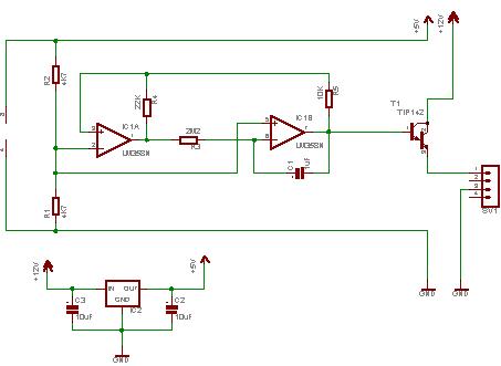

Hi all.
i'd only ask if this may work. the only diference is that i changed the NPN as i want to drive a high current (55-80 Watt at 14V) halogen bulb with this and append an voltage regulator to get the 5 volt source.
The NPN is :
TIP 142 = TIP142TU
NPN 10A/100V D TO218
stepping voltage down for oscillator is fine, (maybe you won't even need it, just read the datasheet for your opamp). but it is unrealistic to expect proper output from such circuit (load in emitter circuit). from circuit operating on 5V, even if opamp output would go to the positive rail, darlington would drop it some 1.2-1.5V (reqired to get base current). the output voltage (at the load) would be at best 3.5-3.7V...
