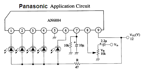

schematic is attached..picked it up from some site
tell me...if i connect it to a cd player....will the LEDS blink n fall like dey do in equaliser?

It might if its schematic gets corrected. U2, U3 and U4 are all wired differently. They should be connected like this:
