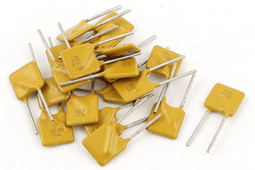

Hello here, i have a problem identifying three legged component on automatic PIR light switch, it’s capacitor or something exotic? many thanks

Looks like a PolySwitch, a positive temperature coefficient resistor that acts as a self-resetting fuse.
Or, could be two back-to-back Y capacitors as part of a power line filter (although I've not seen one).

I dont see 3 legs on the yellow disc ? Which seems to be marked as a 430
pf ceramic capacitor.
Regards, Dana.
Zoom out a bit, so that some adjacent components, and any circuit board markings/designators, are visible.
It looks like a PTC resettable fuse.
ak
Solution
strangely it has three legs
As it has V1 printed next to it, that makes it look more like a VDR - however, while it has three legs it has two obvious separate components inside, one large, one small. This is 'similar' to a posistor, which was used to degauass CRT's back in the day, and consisted of two thermistors, one positive coefficient, and one negative.
But you're still only giving us a tiny picture, so we've no idea what it might be doing - or what it's in - there's no context.
