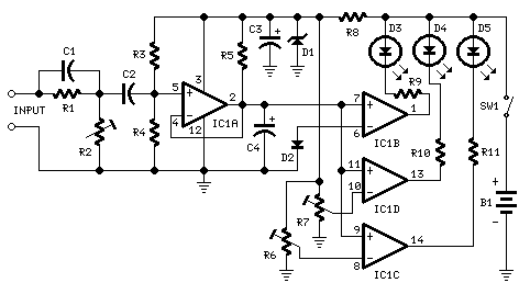

Hi friends, I am Making a 3-level audio meter indicator from the diagram attached...
I want the detailed working of the circuit(what each component will do and how it will work...)
and the solution for increasing the no. of ranges.
also which LED will glow if the i/p is in between 2 ranges(say, 12.5W and 24.5W), D3 or D4????(of course after all settings are done)
please help me.

Circuit operation:
This circuit is intended to indicate the power output level of any audio amplifier. It is simple, portable, and displays three power levels that can be set to any desired value. For a standard HiFi stereo power amplifier like the 25W one described in these pages, the power output values suggested are as followings:
D5 illuminates at 2W
D4 illuminates at 12.5W
D3 illuminates at 24.5W
The above values were chosen for easy setup, but other settings are possible.
IC1A is the input buffer, feeding 3 voltage comparators and LEDs drivers by means of a variable dc voltage obtained by R5 and C4 smoothing action. In order to achieve setting stability, the supply of IC1 and trimmers R6 & R7 is reduced and clamped to 5.1V by Zener diode D1.
Notes:
The simplest way to connect this circuit to the amplifier output is to use a twisted pair cable terminated with two insulated crocodile clips.
Setup is best accomplished with an oscilloscope or an audio millivoltmeter like the one described in these pages.
A 1KHz sine wave generator with variable output is also required (see a suitable circuit in this website also).
Connect the generator to the amplifier input and the Audio Power Indicator to the output of the amplifier, in parallel with the oscilloscope probe or the audio millivoltmeter input.
When using high power outputs disconnect the loudspeakers to avoid Tweeters damage and connect in their place an 8 Ohm 20-30 Watt wirewound resistor.
Remember that VRMS output is equal to output Peak-to-Peak Voltage divided by 2.828.
RMS power output in Watts is equal to VRMS2 divided by speaker impedance (usually 8 or 4 Ohms).
Example: set the output of the 1KHz sinewave generator to read 14V on the audio millivoltmeter (24.5W 8 Ohms). Set R2 until D3 illuminates, and be sure that D3 turns-off when diminishing a little the generator's output.
Do the same with R7 for D4 and R6 for D5. The readings of the audio millivoltmeter must be 10V (12.5W 8 Ohms) and 4V (2W 8 Ohms) respectively.
