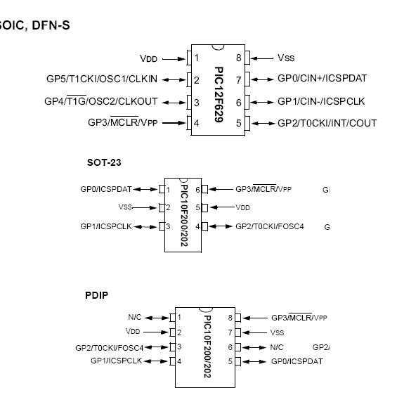

and another thing i observed is similarity between 10f200 and 12f629.it has almost same pins as 10f200(gp0,gp1,gp2,gp3).so can i use the same code with 12f629 with modified circuit?

This is an ouch. Wait till the last minute and then come here asking for somthing ASAP. Sort of sounds fimiilar.
Regarding pins. Microchip has setup its processors so that processors with the same number of pins have the same pinouts. The gotchas are most often that the config bits are different.
The 10f200 processor is a low-range processor and the 12f629 is a mid range processor. It is late at night but I am fairly sure they have different instruction sets.
No I do not think the 12f629 will run 10f200 code.
The low end PIC's are 12 bit, the mid range are 14 bit (16F series, but also 12F629) - the 14 bit devices are upwards compatible from the 12 bit ones, they just have a couple of extra instructions.
So it should be pretty trivial to convert from 10F to 12F.
Thanks Nigel. :eek:
ok it seems better to use 10f200 only.i'll get them soon.
