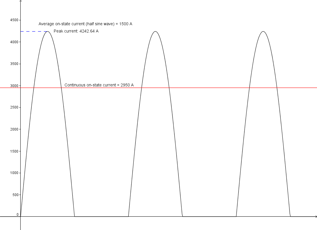

Hello,
I'm trying to understand the difference between current rating on a thyristor datasheet.
Continuous on-state current = 2950 A AND
Average on-state current (half sine wave) = 1500 A
Seems like a large difference in current rating. Is this because the half sign wave will have a large peak current??

That is because on average half sine wave, under maximum conditions the current would peak up to maximum peak current.
Nb: you misread the datasheet. It says Continuous on-state current = 2580, not 2950A (that's RMS).
[edit]
The uploaded figure should tell it all

The difference in average versus RMS currents is that the average is at 55C heatsink temperature and the RMS is at 25C heatsink temperature.
It plainly states that the peak current of 23000A is for a peak one-cycle surge.
You need to read the whole data sheet, not just bits and pieces.
As Carl pointed out the temperature has a lot to do with it too. One rating is at one temperature, and the other rating is at another temperature. That's a little strange but if you make a note of the temperature difference PLUS the fact that one rating is rms and the other is average, you find that the ratings are comparable. We can go into the math behind this if you would like to see how this works. Basically you would convert one rating into the other and then scale for temperature. You should come up with comparable ratings.
