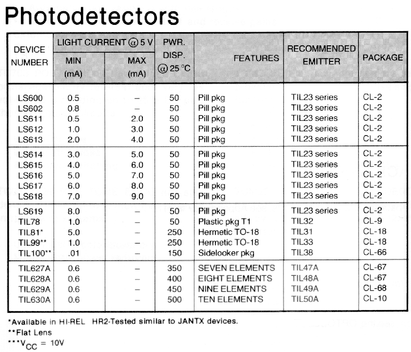

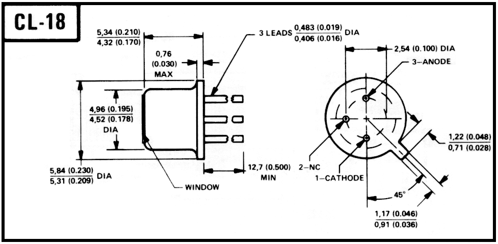

I'm looking for the datasheet of a photodiode - TIL81, I cant really find it on the search engines. Can someone help? Thanks.
It's pretty old... Just scanned from my old TI catalog '83.
