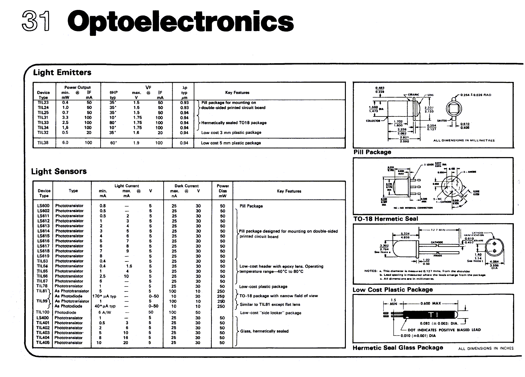

hi all
i need a datasheet for til81.if the light intensity of the source is varied whether the output will vary or not.what is the light source i have to use and now i m using ordinary led.whether i can use led55.plz help me
sakthi

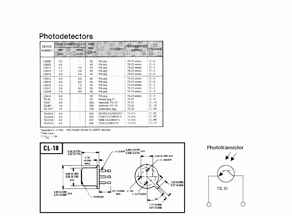

Here is the best I can do.
hi
i have a doubt.whether the output voltage of this til81 will vary with respect to the transmitter end light variation
