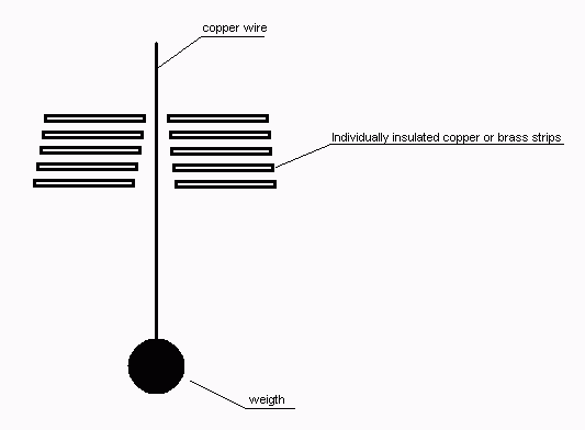

I was wondering whether i could make somthing where when placed on an uneven surfuce would result in a set of LEDs out of a row lighting up, eg if the surface was sloped to the left then the LEDs on the left of the product would light up, so the user could adjust the surface accordingly, to make it even.
However when searching on the web i found similar products that either used electrolyte or accelerometers to sence the tilt. I was wondering whether there is anything simpler that i could use?(like a PIC, or a tube with a ball bearing in it so when the product is tilted the ball bearing will meet with the contacts on that side and cause the LED(s) on that corresponding side to light up.)
The end product does not have to be complex and the simpler the circuit the better. I would be grateful if anyone had any suggestions, schematics or websites that i could look at.

Neel,
I don’t know if this makes any sense to you, but the strips should be connected to the LEDs one for each. And the copper wire must be the “soft” type, my idea is the more it tilts the more strips the wire touches and more LEDs turns on. If you like it is possible to make this device two-dimensional. The wire can be connected to positive or negative depending on how you build the rest of the circuit.
Ante :roll:

Very neat idea ante!
If I may, how about this for a 4 axis modification? Please exuse the poor drawing :oops: Basically , concentric conductive rings, arranged in a funnel shape, that are cut into 4 quadrants.

Zevon,
Yes, that’s about what I meant when I say two-dimensional. Only the split rings should overlap a little to give a reading in any direction. There is a lot more to do with this depending on how sensitive it is allowed to be or must be. An example is that the weight can be lowered in an oil filled container to absorb sudden moves. But then we have to know more about the application.
