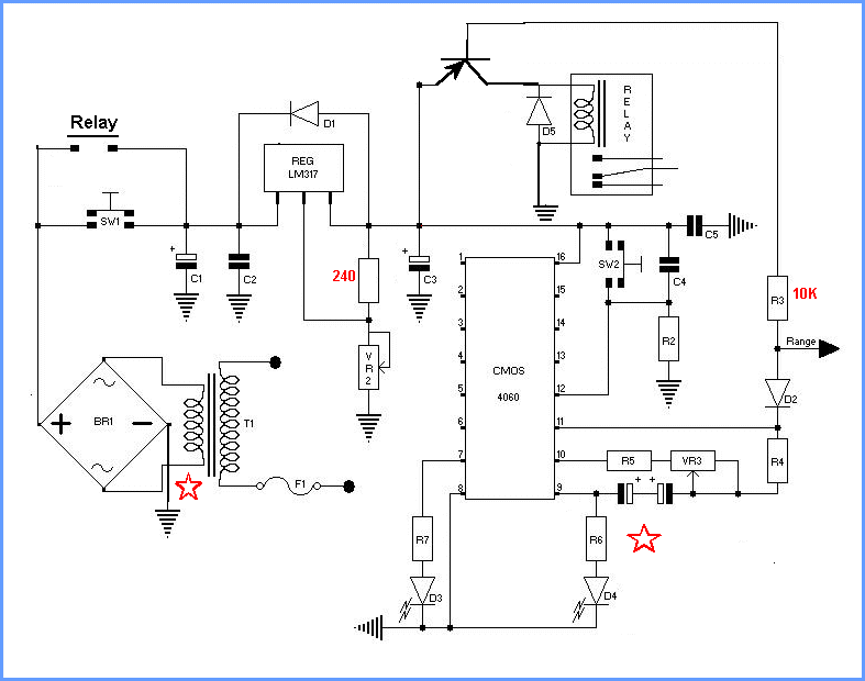

I have adapted (slightly) a 24 hour timer circuit from a certain Ron J (hope this isn't spam, but I believe I should give credit, where credit needs be), to suit my needs. The general idea was to have a "programmable" timer to cut the power to an appliance, for a specified amount of time, with the possibility to turn on and off the timer at will, and to have a reset for the timer. The circuit itself will run on 12 volts. Other than that, I do not think the rest of the info to be relevant to my problem.
When I would close SW1 (momentary pushbutton), the circuit should turn on, closing Q2, keeping the circuit on. The Relay should energize and cut the power to the appliance. The timer should also start the countdown. When the countdown reaches zero, Q1 should then cut the main power, deenergizing the circuit, and turning the appliance back on.
But what I am unsure of, is, when the timer sends Q1 high, will the circuit actually turn off? When the circuit loses power, Q1 should revert to NC state, closing the loop. Will Q2 have enough time to reverted to NO? Is there a charge large enough in the circuit to keep Q2 on when the timer sends Q1 high (thus making all this work useless)?
These questions could be irrelevant if I could make sure Q1 stays on long enough to actually kill the power and untrigger Q2?
Is this possible? If so, how (hoping that it isn't too complicated)? I have tried to research the matter, but as you can guess, no luck, maybe my noob status caused me to complicate things too much...... If there is better than what I came up with, please don't be shy.

As drawn your circuit will not work.
Q2 will not hold the power on, the voltage supplying the base current is less than the voltage at the emitter, this is due to the LM317. Ergo Q2 cannor possibly be turned on.
VR1 and VR2, although there will be a range of adjustments where these will work, if both are set to low (zero) resistance, the LM317 output will be short circuited.

The original circuit by Ron J look ok, but your variations are not going in a favourable direction! :( :(
Define your exact requirements and we will be able to help you.
I assume what you wanted is pressing SW1 would turns relay ON and after sometimes the relay and the unit turns OFF.
The modified circuit can suit your need. You are better off using a spare contact from the relay to switch off the circuit. Use a relay that has more than one pair of contacts.

Ahhh I understand your circuit a bit better now. The 4060 is being used how I said it would be, only your schematic doesn't show which of the outputs you're using. That's why I became confused as to what the 4060 should be doing. With the range output connected to a relevant output on the 4060, the timing part of the circuit should work.

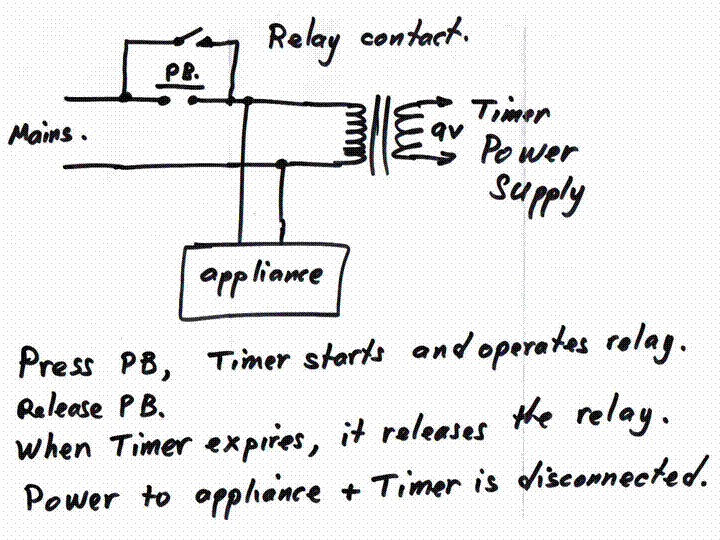

I recently designed a similar circuit for a friend.
He wanted to turn a fan on for a particular time and then switch it off. So I connected the start button in series with the mains with the relay contact in parallel. Thus no energy is consumed when it is off.
When you press the switch, the unit is powered, the relay operates and holds the power on after the button is released. After the delay, the timer releases the relay and the mains power is switched off.
Len
Putting the switching mechanisms on the mains? Meaning before the transformer? Or after?
Both transformer and appliance take the same voltage, while one is on the other is off. If before the transformer, then would an SPDT type relay be optimal? When relay is energised, power goes to timmer unit, when deenergised, power goes to appliance. If after the transformer, then I guess I would need a DPDT relay? One pair for the timer unit, one pair for the appliance. Which would be best?

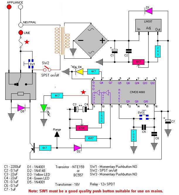

I will be making a new schematics, with all the bells and whistles, hoping it to be my final one. I will post it up, maybe it can be of use to someone else.
Well here it is. Hope this fans out.
Since the original schematics had a 4700 ohm resistor in series with the base of the transistor, and eblc1388 changed that to a 10k ohm, I know not which to use, so I didn't identify it. Shouldn't cause any trouble though.
Thank-you Everyone.
You can use 4K7 for the resistor. The connection of the LED D3 and 4K7 should be directly to pin9. Please use a fuse with suitable rating to match your load.
Oops. For LED D3, it was my mistake when redrawing schematics. Thanks for pointing that out.
For the fuse, I thought only about protecting the circuit. Since the load (3 water pumps) are plugged directly into "the wall outlets", I didn't believe I should need one for the load. To protect the load, I would need a much higher rated fuse, could that protect the circuit anyway? Use two, I guess.
