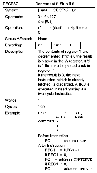

The delay subroutine is supposed to make a delay of 1ms...I've calculated the time by myself and found that the dealay time is 994us not 1000us=1ms.
I don't know whether my calculation is wrong or the result is approximated to 1ms... what's the matter?!
I depend with my calculation upon considering the goto instruction takes 2 instruciton cycles and decfsz instruction only takes 1 instruction cycle.is that true?!
Not according to the datasheet:
Run the routine through the MPLAB simulator to get definitive answer on how much is the delay precisely.
994us or 1000us? Have you taken into acount the act of calling the delay routine? That's 4usec for calling and returning from the routine. Is it that important in your application?
