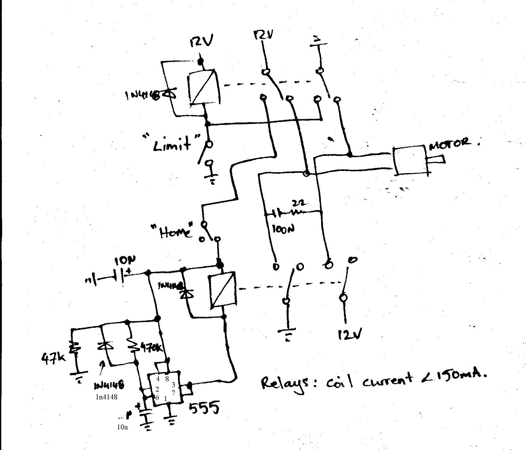

i am trying to get a motor to start up travel a distance then when it hits limit switch the motor stops and waits 5 seconds then reverses where it hits lower limit switch and then stops. this procedure then repeats whenever power is applied, i am using a small 12v motor as a demo just to provide proof of concept to people than it can be done.
Maybe you could try something like the thing I've attached. When power is applied, the top relay drives the motor forward. When the motor hits the limit switch, the top relay latches itself on, and the motor stops. With the top relay on, the lower circuit is provided with power - the 555 timer circuit turns the lower relay on when its timing capacitor charges sufficiently. With the lower relay on, the motor reverses until it hits the home switch, which turns off power to the lower circuit and stops the motor.

tried that and it did not work, just acted as though the timer was not present. started the project off holding the bottom limit switch and the motor turned cw as expected when it hit the top limit switch it then went ccw as it came away from the top limit it then reversed again and again in a never ending loop.
Um, it should work - unless your wiring's wrong or your test method's wrong (or my understanding of your question is wrong.. - it's designed to make the motor go forward until the 'limit' switch is hit, delay a few seconds, then reverse the motor until the 'home' switch is actuated).
Just ignore the bottom 'home' switch for now. It's only used at the end of the cycle.
So the motor keeps ramming the limit switch turning it on/off/on/off (i.e. forward, hits limit, reverse, release limit, repeated)? If the top relay is wired correctly (the switched-ground contact going to the coil), after an initial press of the 'limit' switch, the top relay will activate and hold itself on until power is removed - therefore the motor cannot go forward again until the power is cycled.

sorted out the bounce on the motor it now goes forward hit s limit switch then returns and stops at bottom limit. it just does not wait the couple of seconds at the top?
