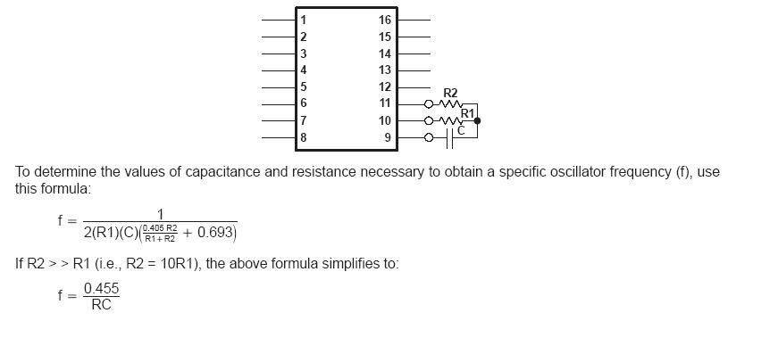

hi again,
comparably small error is okay for the circuit...
now i wanted to set the frequency of the timer.
i found the design formula were different from various sources.
I'm using 74HCT4060 instead of CD4060.
Edit: What are the maximum values of R1,R2,C i can have?

ok Reloadron, will have to find that here...
Just to my curiosity:
Anyone knows 'How to set duty cycle in 4060?(/ similar IC's)'

What do you mean by "set the duty cycle"?
Ron
OK, Read this link down to "changing the pulse width. However, you do realize that you will need a few added components.
Ron
