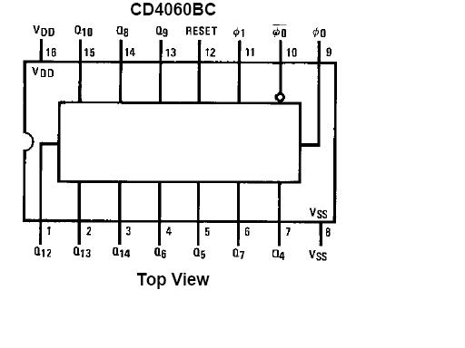

Timer Circuit...Can I Replace the 4020 with a 4060?
calenk

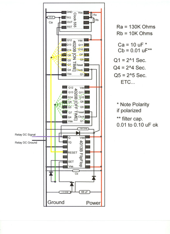

Im making a timer for a water pump, out of a 120V Solid State Relay.
its has adjustble ON and OFF delays from 2 seconds to 4h 30min.
Pin # Schematic Pin Delay Time
9 Q1 2 sec
7 Q4 16 sec
5 Q5 32 sec
4 Q6 ~ 1 min
6 Q7 ~2 min
13 Q8 ~ 4 min
12 Q9 ~ 8 min
14 Q10 ~ 17 min
15 Q11 ~34 min
1 Q12 ~ 68 min
2 Q13 ~ 2 hr 15 min
3 Q14 ~4 hr 30 min

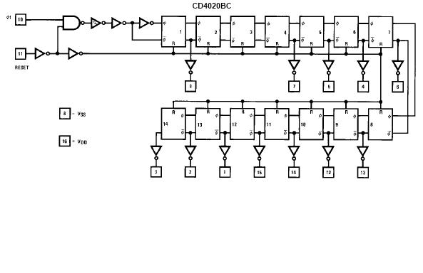

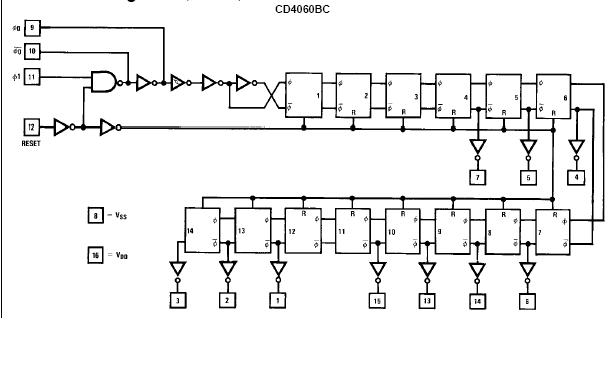

Now im wondering if i can do this circuit with a 4060 counter...cause i dont have access to any 4020's.
i also would like to change the interval timings to something like 1 second to like 8 hours for the OFF cycle.
would this be the proper way to change this...is this schematic even correct....could someone post a schematic of a timer capable of this?

Im sorry but i dont really understand these cmos chips to much....i cant understand how to incoperate the 4060 into this timer and what effect it will have on interval delays

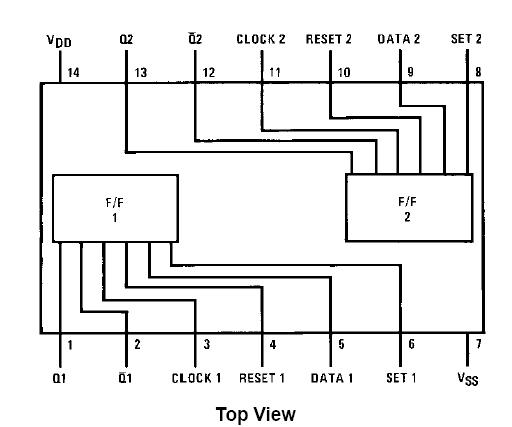

Since the 4060 haven't Q1 and Q11, the 2sec and the 34min not available.
But You can use the another section of 4013 for Q11.
so how would i incorperate the 4060 into this circuit, and how will it affect the interval times....a schematic would help

i cant draw a schematic because I cant tell where the the connections go on your circuit..

oh yea the schematic i posted also has and "auto on feture" meaning it automatically start in the on cycle when power is applied...that what these component are for i believe.
Res. at bottom = 1K ohm
Res at middle = 10K ohm
Cap. at bottom = 68 uF
again i dont know much about this stuff....so im not sure
