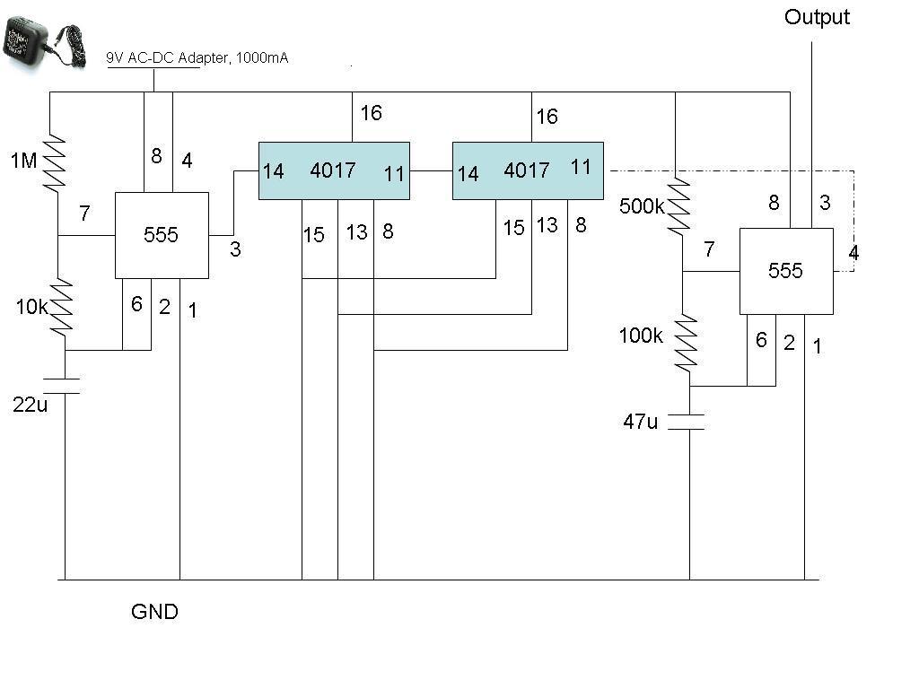

I connected 1 555 timer and 2 IC 4017 counter.
when i supply voltage by 9v DC battery, all the timing no problem,
but once i supply using 9v AC-DC adapter, the timing are not in sequence, and on randomly.
Example:
i connect 1st IC 4017 9th output to a LED, and 555 timer output to 4017 clock input.
By right it should 10 pulse from 555 timer, and 1 output pulse from 4017,
for my case, it keep random blinking on 4017 output.
Can i know why it can happpen?
Well, looking at your schematic... oh wait! You haven't posted one. How are we supposed to evaluate your circuit?
Sorry about that, here my circuit schematic

Pin 15 of each 4017 is its RESET pin that you must activate when the power is applied to the circuit. A resistor and capacitor will do it.
All electronic circuits need a supply bypass capacitor that yours does not have.

Thank you for your information, i will try it later.
You need a whole different adaptor. You might try connecting a large value electrolytic capacitor where the power connects to your project board. Use the largest capacitor you can find, but it should be at least a couple hundred micro farads. Make sure it's rated for the voltage you're using.
Pin 5 of the 555s should be connected to 0V via a 10nF capacitor.

Hero999 i agree with you. i have stoped using 556 since i discovered this. the cirfuit above need some filter to reduse noise becuse 4017, 4013, 555 and other clock inputs respondes to noise easily.

thank you for all your help...finally my circuit work without any problem with adding one small supply bypass capacitor from supply(+) to GND.
