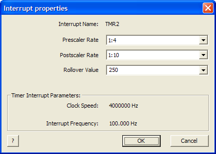

I am utilizing the TMR0 interrupt in flowcode set to one second, but it is slightly inaccurate. I must use a 4mhz crystal on the PIC. I don't know if there is a simple revision I can make, or if I can do it another way.
It is actually counting minutes, every 60 cycles.

The way to get it accurate is to use timer 2 setup as in the attachment to generate 100 interrupts per second.
Edit, to get the 250 value you need to enter it and then press ok.
