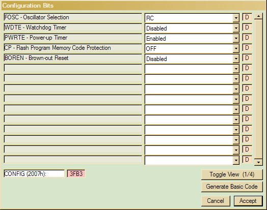

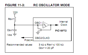

hi ritesh,
What are the R/C values of your RC Oscillator circuit.?
Look at this CONFIG reg value.
    list    p=16f72
    #include "p16f72.inc"
    errorlevel -302, -207
;;    __config b'00000000011111'
    __CONFIG 0x3FB3

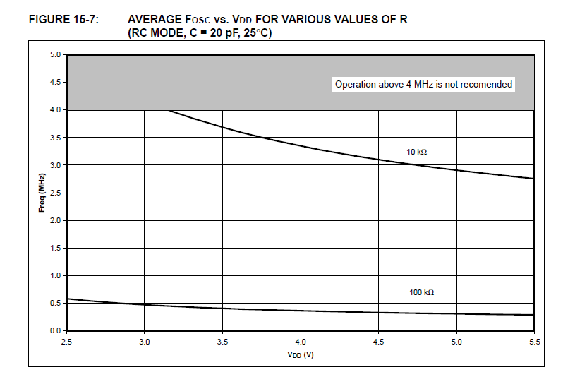

From the datasheet:
I wonder if the oscillator is even running.
Ritesh: Do you have a resonator or crystal to use?
John
