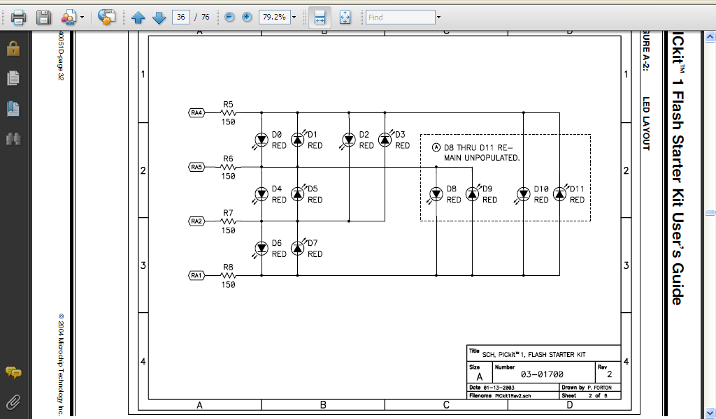

I am a former AVRmega8535 programmer. a new job and now it is PICkit1 and pic12f675
Does anyone have a simple Timer1 assembler application, running on this device, switching on and off a single diode. I am programming in MPlab
The pickit1 Charles plexus the leds on the board I have some code for it but I have to find it
This is a simple code to flash a LED, don't forget to setup the PIC first, ie CMCOn and turn TMR1 on etc.
Gee I'm dumb. I thought PICKit1 was a programmer (ie like the PICKit2) that he was using to program a 12F675.
Thanks for the correction. :) And I think we might have lost the OP...

That looks like some of my ancient assembler code that you have modified. :) Where did you get it?
There are a few obvious faults, you need to seriously go through it. Your interrupt is timer0 but you seem to want timer1.
The int toggles RA4 which is NOT an output pin. You include says PIC 12F675 which doesn't have PORTA or RA4 anyway. You loaded T1CON twice, but one says PIE1. Then you load TMR1H twice.
Even if you sort out the ports and PIC include and get it to flash a LED in the interrupt it will probably flash too fast to see and just look liek the LED is on all the time.
Like I said, spend some serious effort and go right through the code a couple of times...

	list      p=12F675		; list directive to define processor
	#include <p12f675.inc>		; processor specific variable definitions
; MPLAB stuff here
	LIST b=5, n=97, t=ON, st=OFF
	; absolute listing tabs=5, lines=97, trim long lines=ON, symbol table=OFF
	__CONFIG  _CP_OFF & _WDT_OFF & _BODEN_ON & _PWRTE_ON & _INTRC_OSC_NOCLKOUT & _MCLRE_OFF & _CPD_OFF
; Code here
	org 0x000 			; Set program memory base at reset vector 0x000 reset
	goto setup			; set up ints and port stuff
	org 0x004			; Interrupt vector, int handler code comes next.
;  INTERRUPT HANDLER     (runs this code each timer1 interrupt)
int_handler				; first we preserve w and status register
	movwf 	w_temp      		; save off current W register contents
	movf	STATUS,w          	; move status register into W register
	movwf 	w_status      	 	; save off contents of STATUS register
	movlw 	b'00010000'		; mask for bit 4
	xorwf 	PORT_GP,f		; toggle PORTGP,bit3 (toggle the led)
	BCF 	PIR1,TMR1IF		; Cleared timer1 interrupt register overflowed
	movf 	w_status,w     		; retrieve copy of STATUS register
	movwf 	STATUS            	; restore pre-isr STATUS register contents
	swapf 	w_temp,f
	swapf 	w_temp,w          	; restore pre-isr W register contents
	retfie				; return from interrupt
;  SETUP	(runs this only once at startup)
setup					; goto label
;  Timer1 --- TIMER1 CONTROL REGISTER address 10h
	movlw b'00110001'		; Used to set up timer
	     ;  x-------		; 7, not applicable
	     ;  -x------		; 6, 0=>timer is on / 1=>timer is on if T1G is low
	     ;  --x-----		; 5  	prescale selection
	     ;  ---x----		; 4  11 = 1:8 / 10 = 1:4 / 01 = 1:2 / 00 = 1:1 Prescale Value
	     ;  ----x---		; 3  1 = LP oscillator is enabled for Timer1 clock / 0 = LP oscillator is off
	     ;  -----x--		; 2  1 = Do not synchronize external clock input / 0 = Synchronize external clock input
	     ;  ------x-		; 1  1 = External clock from T1OSO/T1CKI pin (on the rising edge)/0 = Internal clock (FOSC/4)
	     ;  -------x		; 0  1 = Enables Timer1 / 0 = Stops Timer1
	movwf T1CON			; load data into OPTION_REG
;  Timer1 --- PIE1  PERIPHERAL INTERRUPT ENABLE REGISTER 1 --- 8Ch
	bsf	STATUS,5		; shift to bank1 control registers
	movlw b'00000001'		; Used to enable interrupts only bit0 is used for timer 1
	     ;  -------x		; 0  1 = Enables Timer1 interrupt
	movwf 	PIE1			; load data into OPTION_REG
	bcf	STATUS,5		; shift to bank0 working registers
;  Timer1 --- TMR1H --- 0Fh   and   TMR1L --- 0Eh
	movlw 	0h			; Just clear TMR1 and let it roll each flash
	movwf 	TMR1H			;
	movlw 	0h			;
	movwf 	TMR1L			;
;  Port setup
	clrf 	PORT_GP			; port is Cleared no output yet
	movlw b'00000000'		; GP4  = output to LED
	movwf 	TRIS_GP			; send mask to porta
;  INTCON Global interupt enable
	movlw b'11000000'			; only bit 4 snd 5 are set as output rest is indput
	      ; 1-------			; GIE: Global Interrupt Enable bit --- 1
	      ; -1------			; PEIE: Peripheral Interrupt Enable bit --- 1
	movwf 	INTCON				;
	goto 	main				; start main program
;  MAIN     (main program loop)
main						; Main program rest til next interupt
main_loop					;
	nop					; in this program main does nothing
	goto main_loop				; keep running the main code.
	end					; no code after this point.
