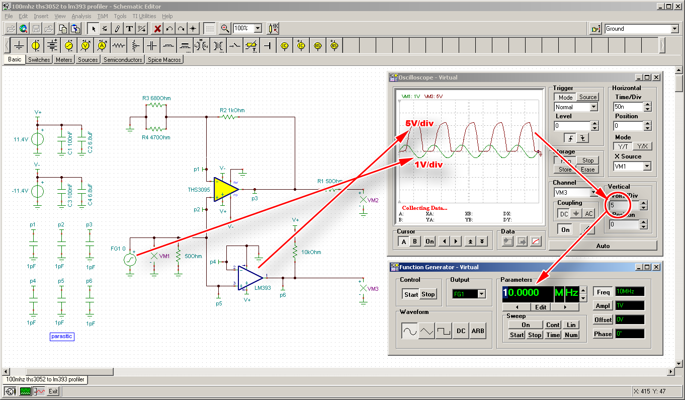

Hi newbie here. Firstly, sorry if my post got mistakes... I just downloaded TINA-TI from Texas instrument. tried to simulate some stuff, ie mix between TI Chip THS3095 and LM393. Long story short, Tina cannot simulate LM393 behaviour properly. From simulation, i can get LM393 "comparating" at/from 20++ MHz 1Vpp Sine signal. But in the real life circuit, i only can get LM393 stable up to 1.5MHz only. beyond that (2++ MHz), LM393 will simply flattened)
So if i were to trust the simulation, directly make the pcb and solder the components, expecting it to work up to 20++ MHz, i will be in total dissapointment. So any advice from expert here? is this the end of SIM for me? ie just rely on datasheets and make the real circuit right away, and do the debugging later? on the real circuit? or is there still hope for the SIM? any better model available to simulate LM393?
Here is my current LM393 model which i got from TI's site (ti_pspice_models.zip). And i provided the picture of the simulation result (tina.png) vs the real circuit behaviour (real.png) Hope to hear some advice. thanx.

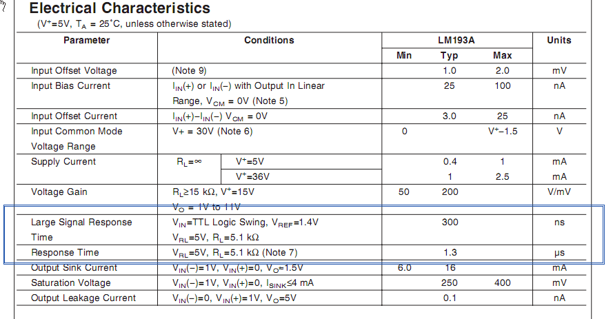

No way will a LM393 work at 20MHz in the real world.
Look at this clip from the pdf.

Looking thru the LM393 model that you posted, it was created in 1990, I would suggest you search the web for a more up to date model.
If you post your Tina file for this project I will try it in my Tina program.

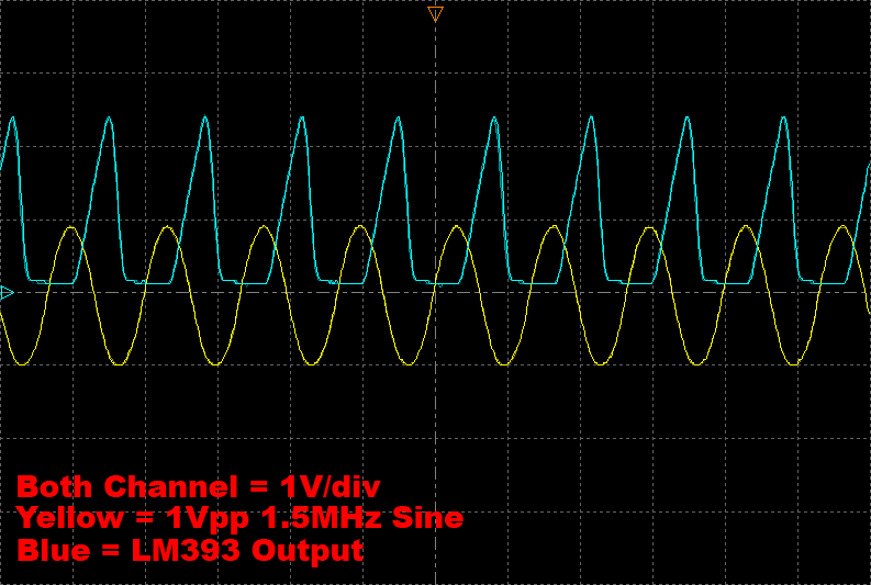

i know and i read the lm393 datasheet. it sure cannot perform at 20MHz. even at 1MHz it start to attenuate. but in sim we still get a usable output up to 50MHz!
and yes, i believe the fault is in the LM393 spice model, i'm reading SPICE book right now, but still a long way to go :(.

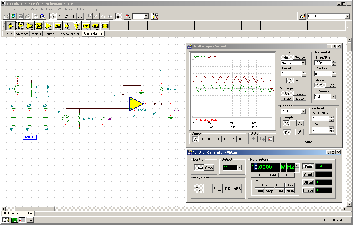

thanx for offering the help eric, here is the lm393 circuit i used. i made simplification by removing the ths3095 which is not the problem and to avoid confusion. i left the parasitic sim intact though.
if there is up to date lm393 spice model, i will be glad to have. finding in google dont give me any luck. thanx.

Here is a newer (2006) LM393 model from On Semi. It still won't work above ~1MHz, but you can put it in your Lib for future use perhaps. I'll also include the model for the MAX961 which will work fine at 100MHz and a little beyond. I had to modify the .asy file to fit the non-default .sub file for LT Spice so beware of that. I'm not at all familiar with TINA. Hopes this helps.

Thanx MrCecil. that will help alot. i copy pasted the spice script name and made LM393x for tina *.tsm/cir/txt (included here). the sim shows better result, but still not the real one. i wont hope too much. thank you.

*.cir should be put in C:\Program Files\DesignSoft\Tina 9 - TI\SPICELIB
*.tsm should be put in C:\Program Files\DesignSoft\Tina 9 - TI\MACROLIB
at least thats what i learnt from their structure. and this is my first install, i dont know if direct copy to library folder is applicable. i tried to make a hack earlier with some model, but tina reported unsuccesfull/invalid library load.
if it cannot work, you have to remake the tsm again by the following step:
1) insert any existing spice macro model (pin compatible) into a new project
2) double click the model/component to enter macro
3) copy pasted the spice macro (*.txt in my case) in the editor and save as *.cir
4) go to tina menu tool->new macro wizard, fill the required form and load the *.cir earlier, save as *.tsm
5)load the newly created model by goto tina menu>insert->macro.
6) done!
thats my dirty hack :p here again i included the test file *.tsc, library *.cir/*.tsm and the main spice macro script *.txt for lm393 (ver 4.03) and lm393x (ver 9.2). i hope that help.
