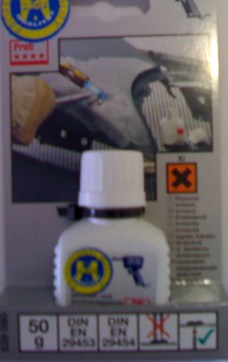

A friend told me about a product so i can tin my boards...

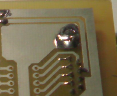

here's some photos of the product a board after i tried to tin it and a guide on how to do it.
http://diypcb.googlepages.com/index.html
they were very cheap and i bought some so if anyone is interested i got few of them for selling.

The problem with chemical tinning is diffusion. The tin layer is about 1-2µm which will disappear after a while having merged into the copper.
For long lasting chemical tinning a diffusion blocker must be applied. Despite that the tin layer must be 5-7µm for a durable coating.
Those chemical tinning sets have been on the market for quite a while and it's not advisable to use them before soldering. It requires moore heat for good soldering on a pad treated with chemical tin.

Hans,
I agree about the chemical conversion coatings. But the link uses Rosol 3 (tin-copper alloy), which is a solder paste. I think it is spread on, then put in an oven or heated with air to melt.
I stopped using the conversion coatings a few years ago and just use lead-tin solder with a good flux. Then, I conformal coat. Since I use the photo method, I leave the photoresist on the boards to prevent oxidation until I am ready to assemble them.

Guys the pcbs can work fine for years even if they aren't tinned!
provided of course that you don't touch the copper all the time.
Now imagine how much better things can be if you tin it with the above product or something simular,
if you ask me i'm very satisfied with the outcome, look at the photo of the board i posted, the common ground is huge! and i'm using a 12V/8W soldering iron to solder on these rails. If someone is interested they are still available and i can get more because they are extremely cheap!
