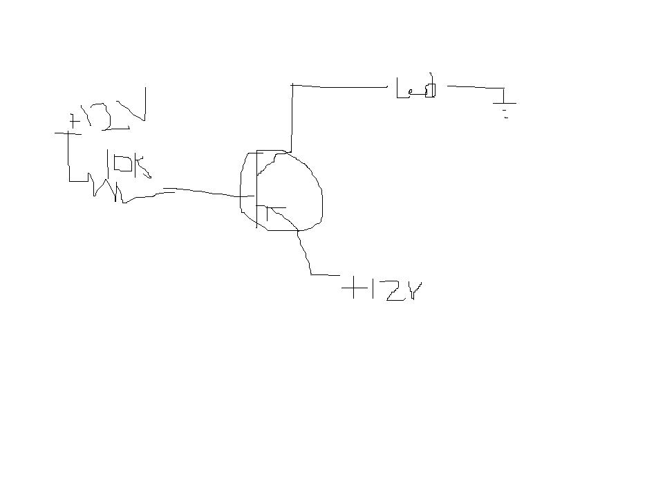

I am using TIP 127 for controlling current of led as load, i have connected the emitter to +12V and collector to led series of 4 (2.2 x 4= 8.8V) using SMPS.
The base is connected with pre set 10K resistance to GND of 12V.
data sheet says 5A with 120mA...maximum..
hi Ritesh,
A TIP127 is a PNP Darlington transistor.
The Collector should be connected to a Negative Supply with respect to the Emitter.
What is the driving source for the 10K Base resistor, do you have a diagram to post.?
here it is...........
The Base must be negative with respect to the Emitter on a PNP, connect the 10K to a -Vsupply to turn on the TIP
I agree that to turn this on you need a resistor from the base to ground or something similar. Depending on your LED current requirements however the resistor may have to be sized a bit lower than 10k. That's because the gain is roughly 1 amp per milliamp, so to see 1 amp collector current you need a min of 1ma into the base as a starting point, and for a full 5 amp collector current you'd need at least 5ma into the base but maybe a little more than that. I would think that a 1k resistor should be able to drive it regardless with a 12v supply (after the roughly 2v base emitter drops that leaves about 10ma base current).

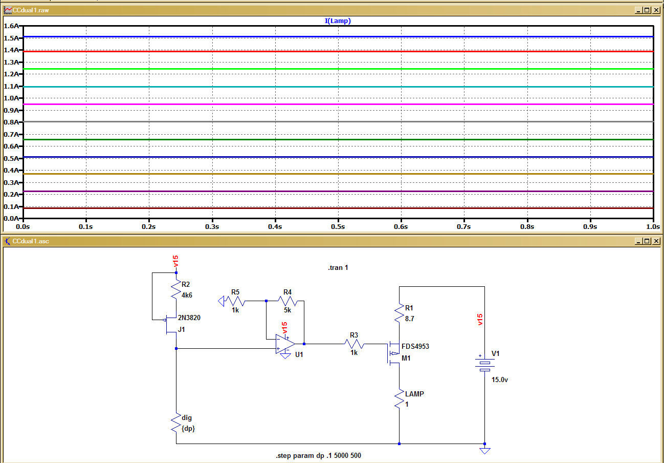

hi ritesh,
You will find that trying to control the current to stable value by using a single transistor will not work.
Look up voltage to current converter circuits
EDIT:
This is an example circuit ONLY.
hi ritesh,
EDIT:
This is an exampel circuit ONLY.

He wrongly thinks that the darlington output current is "controlled" by how much base current it gets so he does not use a current-limiting resistor in series with the LEDs.
He does not understand that each TIP127 darlington can have a current gain much higher than the minimum amount of 1000. He also does not understand that the current gain changes when the temperature changes.
He also cannot understand the Maximum spec's on the datasheet:
1) The maximum allowed base current is 120mA which does not mean that for its maximum allowed collector current of 5A then the base current must also be maximum!
The minimum hFE is 1000 at a collector current of 3A (it is not shown for 5A because then it works poorly) then the maximum base current used is 3mA, not 120mA. But the actual current gain might be 3000 or 5000 when it is hot then the base current is only 0.6mA.
2) The maximum allowed reverse base-emitter voltage is 5V. But it is never reverse in his circuit. The datasheet shows that the forward base-emitter voltage is a maximum of 2.5V at a collector current of 3A and is less at lower current or could be much less. With the 12V supply and the 10k series base resistor then the base current is about 1mA.
3) He uses a "preset" variable resistor for the 10k base resistor then it can be adjusted low enough for both the preset resistor AND the base of the darlington to burn out. The LEDs will also burn out.
