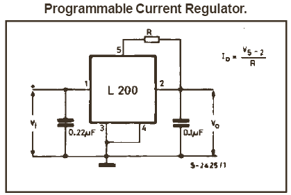

This is the problem I am having - the transistor doesnt switch :( and I cant for the life of me work out why. The image below shows the desired set up - the pins are connected to the 5V source just to simulate the PIC. The 0.45V is supposed to be an example voltage out of the pin 5 of the L200C - I think I am going to have to strip it down to a simpler test

Hi Peter,
1) The L200C regulator has a minimum output voltage of 2.85V, not 0.45V, so most of your load resistances will try to cause a current of more than the 2A max from the L200C.
2) The 180 ohm resistors will create a base current of about only 20mA. If the TIP31C transistors have the minimum current gain of 30, then the max collector current will be only 600mA and the collector voltage will be 4V.

The 0.45V is simulating the equations used to work out the value of R3. R3 = 0.45 / Amps and it is R3 which dictates the current output. The purpose of having all the switches and resistors in parralell is to be able to change the value of R3 in order to control the current.

Hi Peter,
If you are trying to use the transistors to program the output current of the L200 then you shoud have said so in the 1st post.
Notice in the datasheet that the sensing resistor isn't grounded like your transistors would do. Your resistors are the load on the L200.
Transistors won't work anyway because with a load of 2A and even with a very high base current of 200mA, their max saturation voltage is about 1.0V. If you are lucky and get some "typical" transistors then the saturation voltage is 0.32V so the current setting will be much too low.
But your base current is only 20mA, not 200mA.
You need some kind of floating high current switches, like relay contacts.

Thanks for that - can you explain what 'saturation voltage' is please?
Peter
Saturation voltage is the voltage between the collector and the emitter of a turned-on transistor at a specified amount of collector current. Usually a base current of 1/10th the collector current is used.
The max saturation voltage for a TIP31 transistor with Ic= 3A and Ib= 375mA is 1.2V. The graph in the datasheet shows typical saturation voltages with the base current 1/10th the collector current.

Ah... so does this mean because the voltage on the emitter side ( which will be about 7V ) is much higher than the voltage at the collector side, it wont work?
Peter
The emitters of the transistors and the 0V of the PIC will be at about +7V (the output voltage of the L200). So you need two separate power supplies.
The transistors need a base current that is much higher than the max current from a PIC.
The saturation voltage of the transistors is much too high.
