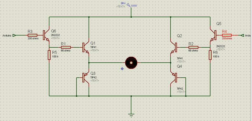

i try to design an h bridge to drive 24 v / 5 amps motor(for a wheelchair) and connect it to arduino , i design a circuit and attached it with this post , i use TIP41/TIP42 and 2N2222 transistors in my design and i use these data form the data sheet :
HFE for the TIP41=15
V(BE) = 2 V
and for the 2N2222
HFE = 30
V(BE)=2.6
are these data correct ???
and this is the schematic...
in addition i need to just control the direction of rotation with no speed control
with thanks

hi W.
What purpose do Q3 and Q4 serve, they are always turned ON.

if Q6 turned on then Q1 will turn on too,thus the current will take the bath of Q4 , and the same is applies on Q3...

hi W,
I see that.:D
But Q3 will be On and Q6 current will flow thru Q3.???

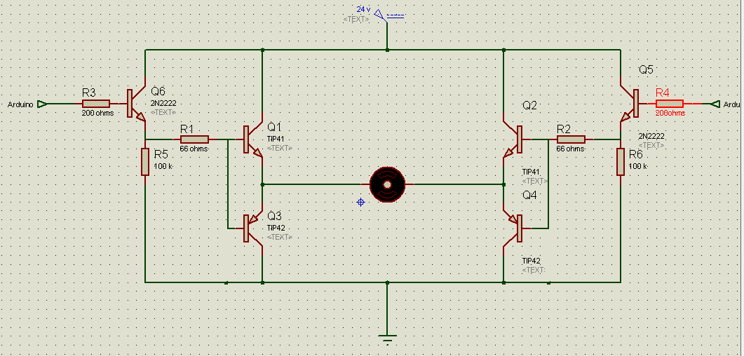

oops ... you are right ... i will modify the schematic ... thanks a lot but abut the calculations of the resistors and the value i used from the data sheet its correct ??
Regarding your calculations, as they are incomplete its not easy to say they are right.
A point to note:
You have Q6 and Q1 as emitter followers.
This means the emitter of Q1 to the motor can never rise above 5V - [2 *0.7V ]... thats assuming the arduino is outputting 5V.
Each emitter of Q1 and Q6 'loses' a 0.7V drop. OK.??
As Q1 and Q2 are being used in emitter-follower mode and you don't have a level-shifter stage between the Arduino and the all-NPN H-bridge the maximum voltage applied to the motor (ignoring the fact that Q3 and Q4 will shunt current to ground) will be the Arduino output voltage (5V) - Q6Vbe - Q1Vbe = ~3.8V.

thanks for all ... i look in the circuit and i will do some modification and re post it a gain >>> thanks for you a gain :eek:

Just a quick tip - to use the transistors as switches (which is what you want), the outputs should be from the collectors, NOT the emitters.
