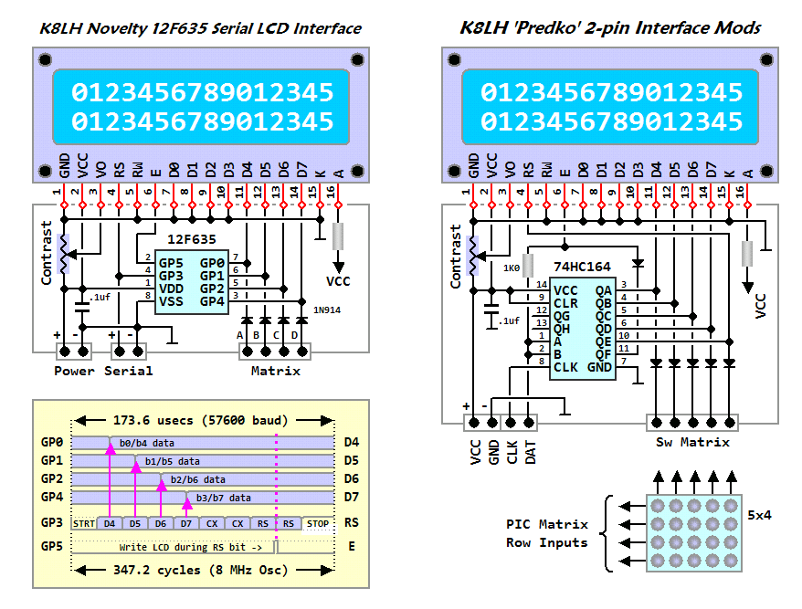

Nice work Roman. Thank you for sharing.
If you're trying to squeeze even more functionality out of that module you might consider a function for setting the D4..D7 and RS outputs, without sending the E pulse, for use as column or row driver lines for a keypad. I've done this with a couple simple 44780 type LCD interfaces now and it works well.
Actually now that I think about it, you could do the whole keypad interface with that port expander IC (duh!).
Take care. Kind regards, Mike
keypad-driver-mods-png.34399
Good one Mike, I didn't think about the keyboard driving.
