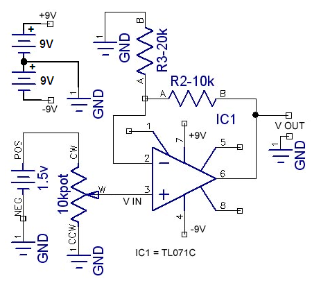

I am trying to input a 0.100 to 0.950 volts into the input of a TL071 op amp to recieve an output of approximately a 17% gain that will keep at roughly that ratio from 0.100 to say 1 volt is this possible?
My test circuit has been configured for roughly a %50 gain and is as follows.
The problem I get with this is that when the input voltage drops to 0.100v the output runs at 9v
The output only corrects itself after the input voltage is more than 0.850v and above.
Any ideas?
Your circuit has a voltage gain of 1.5 as shown.
With 0V input then the output is 0V.
With +0.1V input then the output is +0.15V.
With +0.85V input then the output is +1.275V.
With +0.95V input then the output is +1.425V.
If the input becomes negative then the output is negative until the input is within 3V of the negative supply then the output will suddenly go to +7.8V (phase inversion problem).
Its max output is +9V - 1.2V= +7.8V (not 9V).

To be sure that the circuit is what we think it is, can you please add pin numbers to the circuit, also draw in the 1.5V battery and divider input.:)

I'm still waiting for the circuit with pin numbers and the test battery connections that you using.
Ok here it is
Sorry its so big I just quickly done it then.
Thanks,
A quick look says the circuit should work. I wanted to be sure that you had connected the amp correctly.
You say under 0.8Vin the output is incorrect.
If you set the pot to 0.5Vin what is the measured output on pin 6.?
EDIT:
The divider resistors 10K and 10K variable will only permit a Vin as low as 0.75V.
Perhaps the pot wiper is faulty at one end.
Swop the 10K and 10K pot around, so you adjust from 0Vin to +0.75Vin then see what you get.
at 0.50 volts input, the output is 8.64 volts hehe I dont know whats going on.
same to 0.70
then 0.75 is 8.44
then 0.80 is 1.48
0.90 is 1.44
1.00 is 1.45
1.10 is 1.47
1.5 is 1.75
pin 4 of the op amp is also grounded

Look at my edit and try swopping the 10K and 10K pot around, checking the pot OK.?
Add a 2k resistor between the output and ground and see if that helps. I've had a couple of opamps in the past which have been a bit weird with no load on the output.
Then the opamp does not have a negative supply voltage and will not work.
Also then the negative 9V battery is shorted.
The junction of the two batteries must be connected to ground instead.

Thankyou so much.
I disconnected the ground from the op amp main supply and hooked 2 batteries up as you described with ground on the junction between the 2 and bingo! It works perfect. at 0.100 volts input i now recieve a perfect 0.150 volts output.
