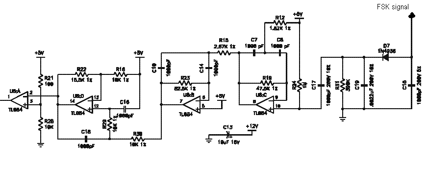

I need to know at what input will the opamp trigger while giving 5v to the inverting end?
Im trying to use it as a filter and the FSK input is around 400mV but I am not getting any output from the opamp....so what is the input level required to get an output??
This is the circuit diagram ...it is the receiver part of the 125KHz RFID system design.
Aren't you pushing the capabilities of the TL084 a little bit too far?
This 125kHz sometime goes through AM peak detection before reaching the op-amps. Possibly, coolrfid's creating a bandpass filter for the 12kHz and 15kHz FSK frequencies.
5V or even 400mV will be enough if your ± supply voltage is in the recommended ±5V to ±15V range
Since you're using a quad op-amp , I'll just wager you're using the TL084 to make Sallen Key filters and inverting amps. A lot of Sallen Key filters I find have unity gain. So if you're putting 400mV in, you should be getting almost 400mV out...unless it's outside your passband.
...That's just based on my guesses. First thing, post a diagram so we can see your amps/filters. Then tell us what frequency this 400mV is.
Also keep in mind the TL084 can't produce an output if the load impedance is under 100Ω.

The 400mV signal is the FSK modulated signal of the RFID tag around containing the frequencies 12KHz & 15KHz. Ive posted the circuit diagram ontop in d first post....Does the diode 1N4936 make a difference to the voltage level of the signal...can i use diode 1N4148 instead...
What u r saying is right.. im using the TL084 to make Sallen Key filters
The 1N4148 would probably give you a longer reception range because it has a low forward voltage (Vf). A germanium diode might be even better than 1N4148. They are the kind used in battery-less crystal radios, and take very little energy from your signal.
Probably I can look at this filter again tomorrow and make a test recommendation. For now, you should be able to see a 12kHz to 15kHz square wave on the final output if everything is okay (and possibly some 3rd frequency if there is no input at all). I'd start by inputting more 12kHz and 15kHz to see if there is a one or more Sallen Keys dropping the signal.

Maybe start by probing filters A, D, B, C at their outputs and tell us if the 12kHz and 15kHz signals are getting through. Only filter C seems to be running at unity gain, so all the others should actually be making the 12kHz and 15kHz larger. Do you have an oscilloscope available?
