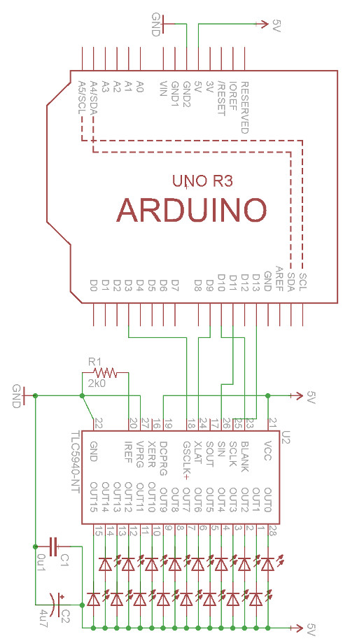

As I have to control servos by TLC5940NT in Arduino Uno.
During testing, the servos are not rotated as per command and sometimes it stopped and not working.
The wiring diagram is attached in file.
Simple program I have used for servos testing, given below,

Dear Burt,
I have tried exactly same way as told in your reply.
But still servo is not rotating in commanded fashion.
Regards,
Nirav
Im sure if not hooked up right it will not work that chips made for driving leds there using pullups to keep it from thinking you have a broken led.
