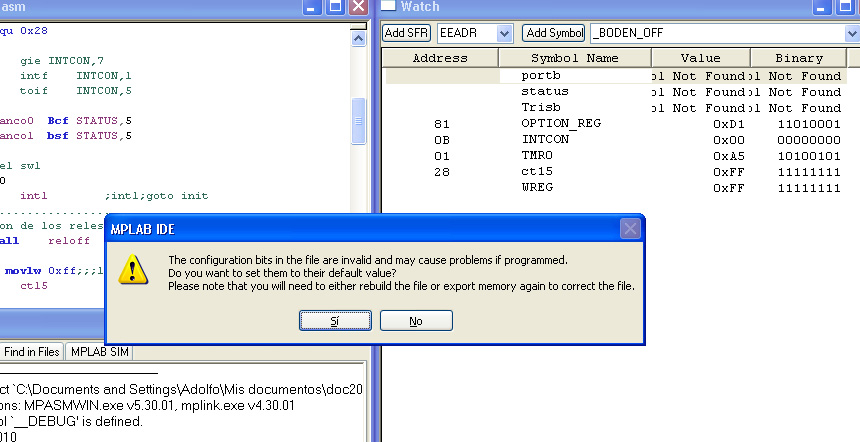

I try it , but it shows the following screen in the Mplab
""picture attached""

Which version of MPLAB are you using, it assembles OK for me in MPLAB V7

Mplab 8.30, but I know why is show me that screen!!
I forgot to change the device in the configuration set
I wil try with it and I tell you

thanks Eric!
yes you are right, it was a problem of definition only
I have to take a close look of the way you right the definitions at the heading
but still I don´t know why it the Watch screen does show me in Portb, Status & Trisb= not found
I´ll be in the search!

All the CONFIG's etc are supplied as part of MPLAB, mine are located here : C:\Program Files\Microchip\MPASM Suite\Template\Code
If you make a copy of the 16F628ATEMP.asm file for the ones you are working on, use it as a template for your planned program.
When you have debugged your existing program post the asm file and I'll run in thru the Oshonsoft sim.
